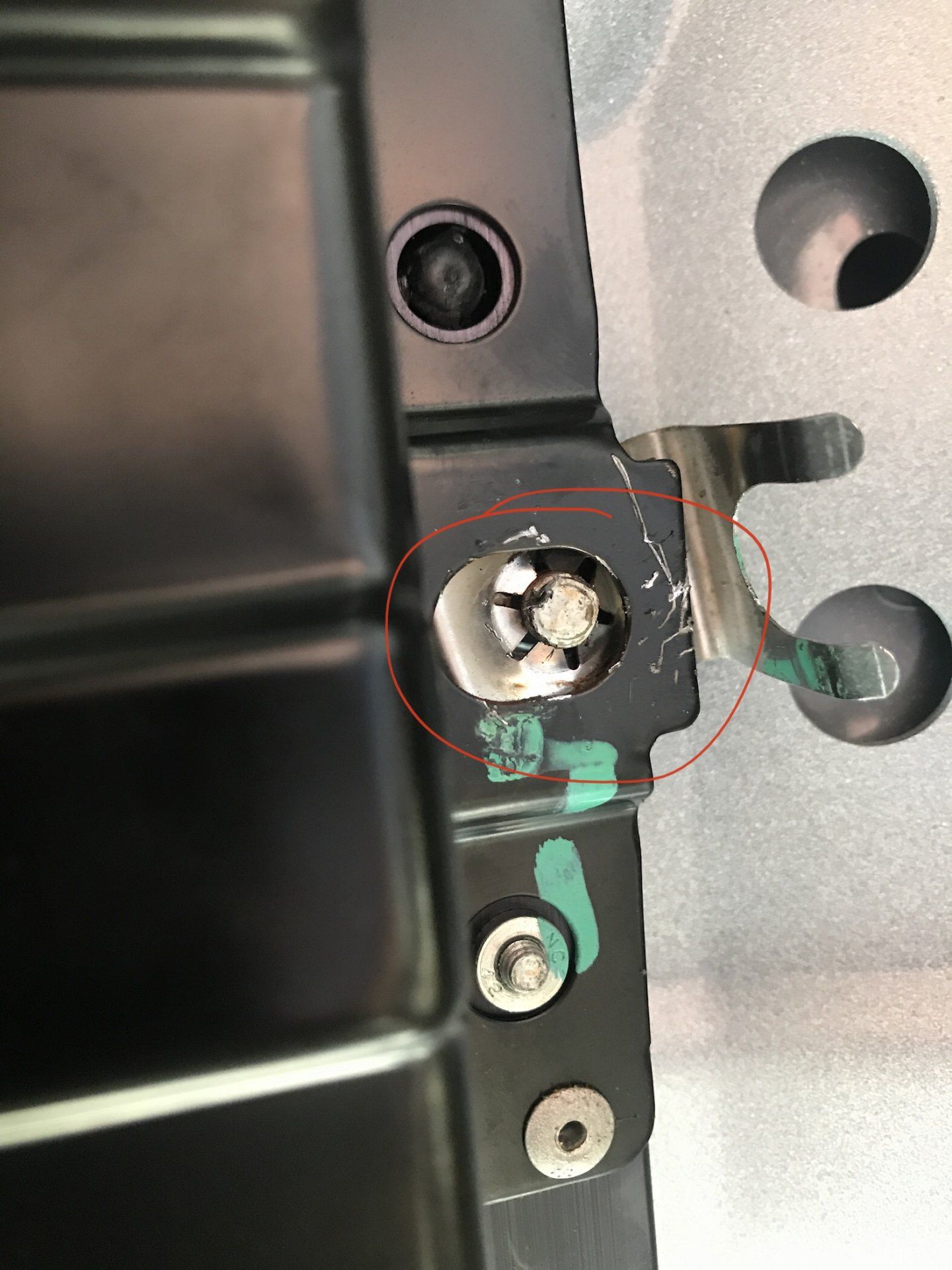

Searched and couldn’t find any info on this piece I’ve unearthed while removing the sunroof assembly frame. Saw a post in a different forum asking a question about it but there was no answer.
what’s the trick to removing this part? It’s the last piece holding my frame in. Started a new thread for ease of others potentially searching for the answer to this problem. Unless I’m missing something very obvious. Thx.
update: just pull down with decent force close to where the bolt is connecting to the body and it will come off. I used my head to catch the frame as it popped off the bolt.:redface:
Yea, I believe there is a ‘hook’ in the roof metal that holds the assembly up while inserting the screws from below. It’s to aid factory assembly.

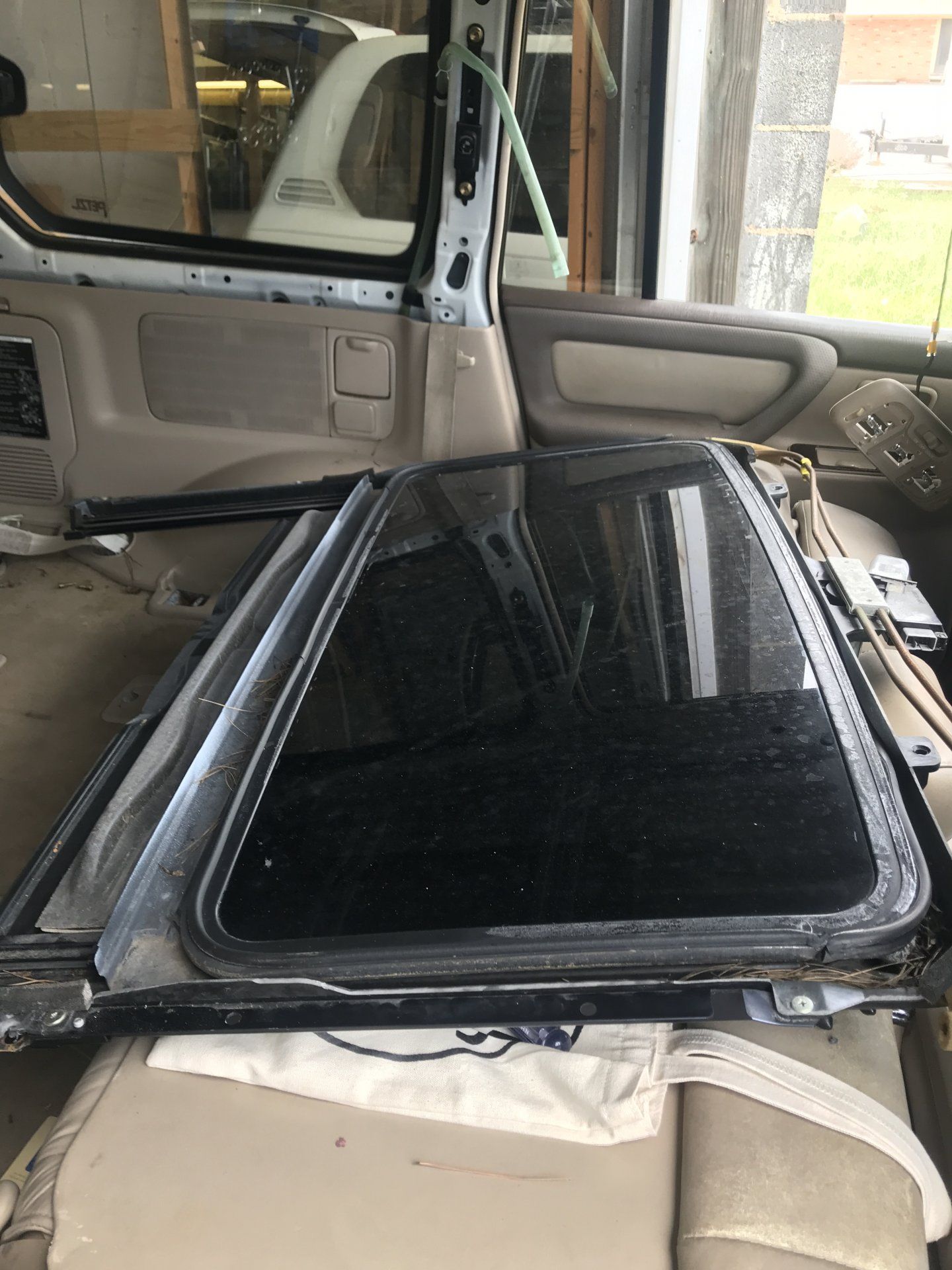

So, how many hours did disassembly take?
the interior panels were pretty straightforward and I got everything off in under 2 hours. Not sure exactly because I didn’t keep track. I’m currently still working on trying to remove the cables from the track/soaking them in penetrating oil to try and free them up. I started at around 1030/11am today.
Once you remove the cables, my trick for cleaning them was to chuck one end up in a drill and grasp the cable with a rag while spinning it with the drill.
