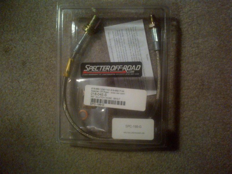

OEM Clutch hose
Not sure if its the same for an 84 but I just purchased a new hard line and hose last week OEM for an 87, so you should not have any issues locating them.

I received my new clutch line from Specter a few days after the last post. At $34 plus shipping it was spendy but with my long work days I simply did not have time to go to a local shop and have one made. So that next weekend with my new clutch line and renewed determination I got after it. I cut the old flex line off and successfully removed the slave cylinder but that damned fitting was firmly attached to the hard line and would not budge. Not to be deterred I grabbed the impact wrench and gave it some torque. Sure enough it came loose but with part of the hard line still attached :mad::mad::mad:.
