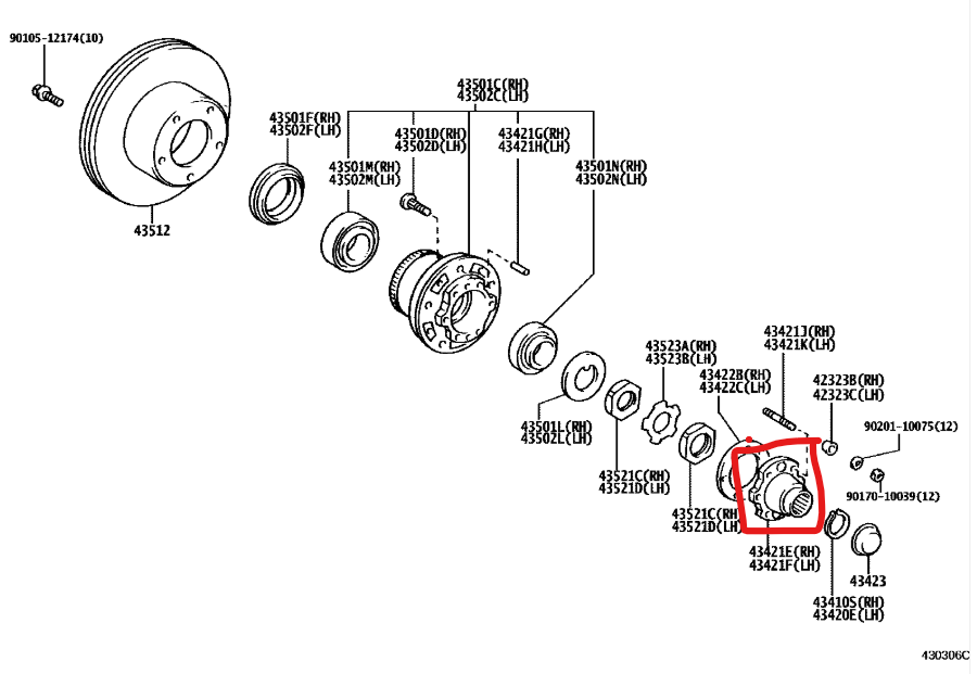

The safest way is to get a couple of used drive flanges and machine or die grind the splines away so they bolt up tot he hub to protect the bearings, but don't engage with the shaft. Removing the half shafts would also leave the bearings exposed to road grit.

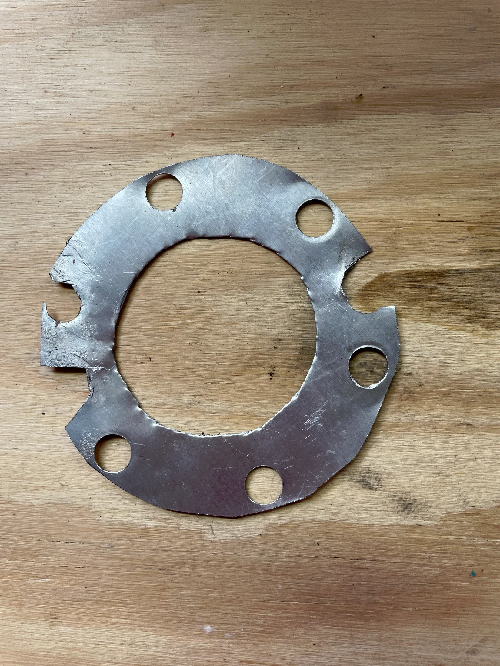

Ben3D makes some 3D printed "flanges" that are like caps that don't have splines - saved my butt when someone had them when I blew my front diff at Windrock. Kept my bearings clean on the way back off the trail.
I made my own version of them after that, but since Ben still sells his (as far as I know anyways) I don't sell them. I think he can be difficult to get a hold of though, so you may try Instagram.
