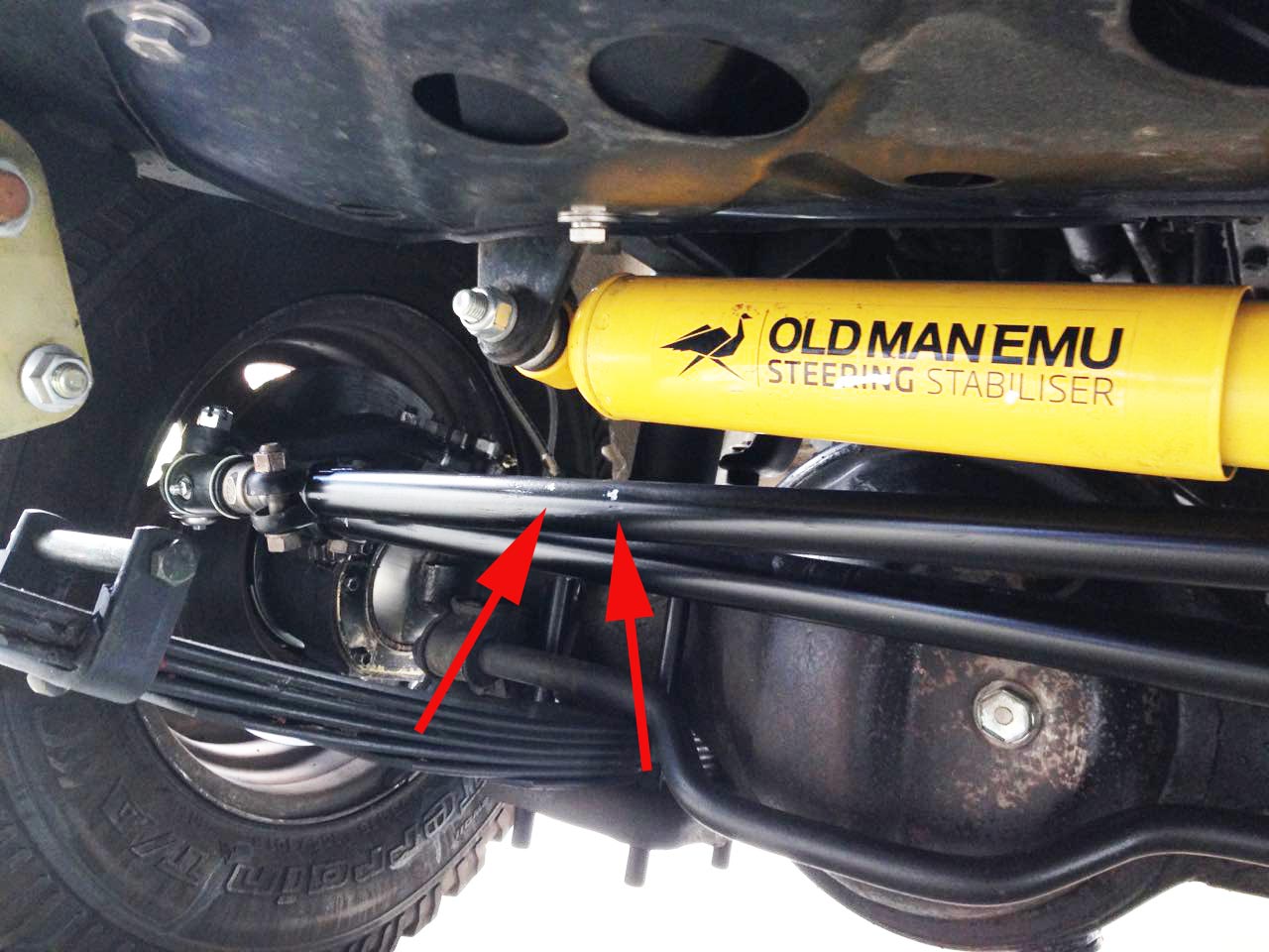

Just finished up a knuckle rebuild (definitely a rite of passage!) and TRE replacement. Just noticed that there were two scratch marks on the relay rod that correspond to the steering stabilizer nut and the top edge of the shock. Never noticed it with the original TREs. Anyone seen this problem or know what I should do to fix this problem? scratched a really nice semi-gloss paint job on the rod!!!
Also note the nice clean knuckle!! ooh lala!
T
The OME has been on there for last 1.5 yrs without scratching prior to replacing the TREs!
Trying to figure out what geometry changed to cause this.
Wondering if I can just flip the stabilizer around and mount it to the eyelet from the front.

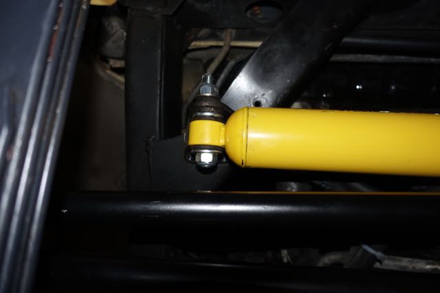

If the OME stabilizer is tilted (like it looks in the picture), water or mud or dirt will end up in the outer protective sliding part/shield and pool at the bottom, unable to drain if it is flipped the other way. I don't know if this is the case.
Nah that's just the camera angle.
See if you can wriggle the rods clockwise / anticlockwise. I'm trying to recall doing my TRE's but I don't recall being able to mess up the angles that much.
Did you rebuild your TRE's or get new ones?
Ome lift was installed 1.5 yrs ago (shackles/springs) along with the stabilizer, with no prior indications of scratching the relay rod.
TRE's were replaced with new 555's from Kurt, after knuckle rebuild.
Wiggled the rods a bit to move the pivot point (TRE bolt) to the knuckle arm in more of a vertical orientation, which moves the bar further away from the stabilizer, but after some driving it self adjusts to its current position.
T
That TRE looks real close to the spring clamp in that photo too.
Did you get a wheel alignment when you finished?
It is conceivable that the new aftermarket TRE link joint knob is just a hair longer than the one one it replaced. If the original allowed the OME stabilizer to just clear the relay rod, and the new one is just a millimeter longer, the new one would cause the OME hardware to rub.

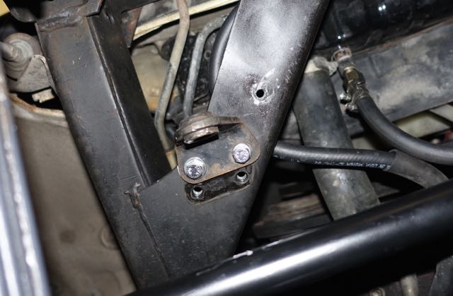

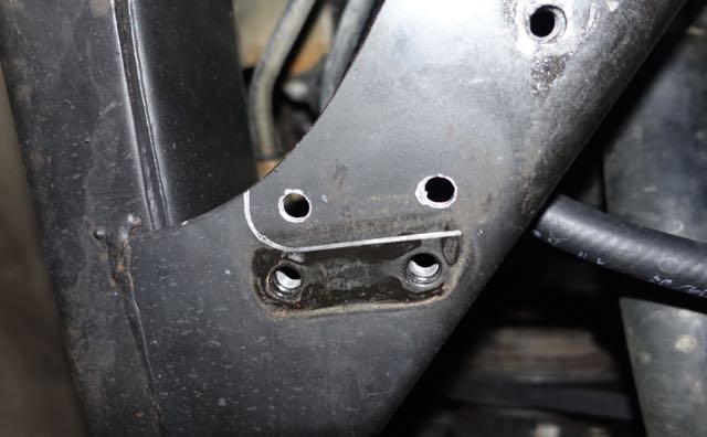

I asked Kurt (Cruiser Outfitters), and he's never heard of this situation before, ugh! Will take it apart this weekend and see if the top bracket can be moved forward ever so slightly to clear the rod.

Moving the bracket is the easiest solution, if you ever change your front spring out you can move the bracket back to it's original position, well done?
