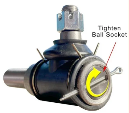

some of the steering tie rod ends have a big slotted screw meant to control the amount of slop on the ball connection. check to see if you're missing your cotter pins or if you can turn in that big slotted screw and tighten up the pressure on the socket. Don't overdo it, it still needs to move around, but snug is good and grease them.
