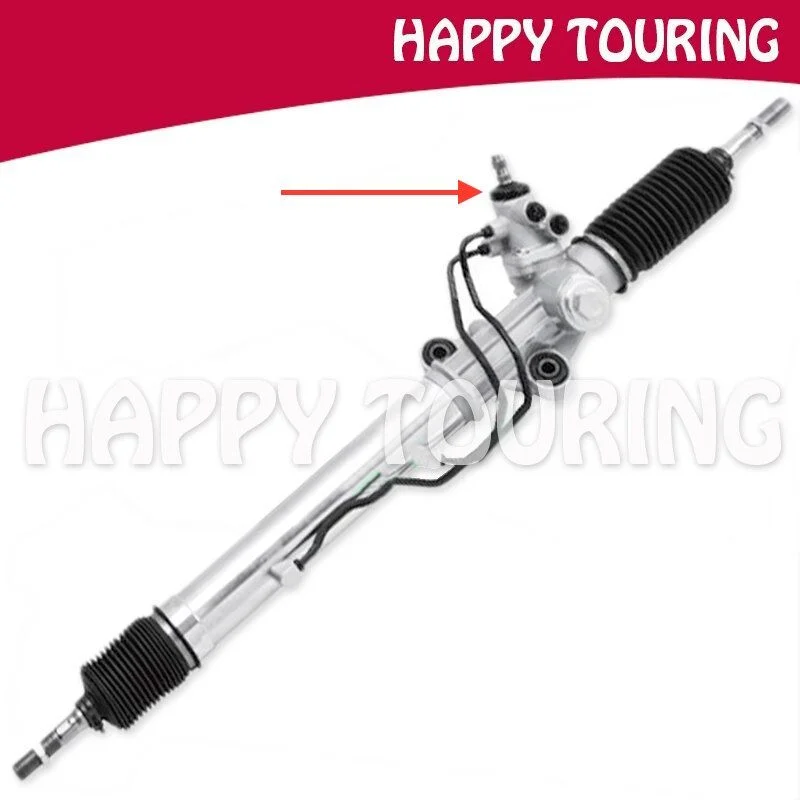

I have a leak as well. Hard to tell where exactly it's coming from but it looks to be this spot. There's a rubber piece that I could move with my finger. It could also somewhere else but its not on the boots.
Is this a common failure point? Is it a possible repair or do I need an entire new rack?
