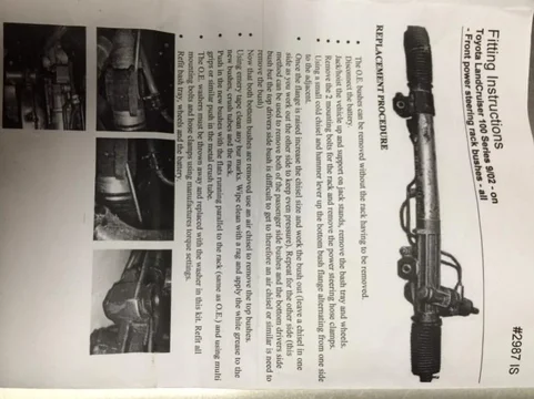

Here is a photo of the super pro installation instructions for 03+ MY, which came with the bushings I ordered locally in Aus. If you order here in the US make sure you order the correct ones.
