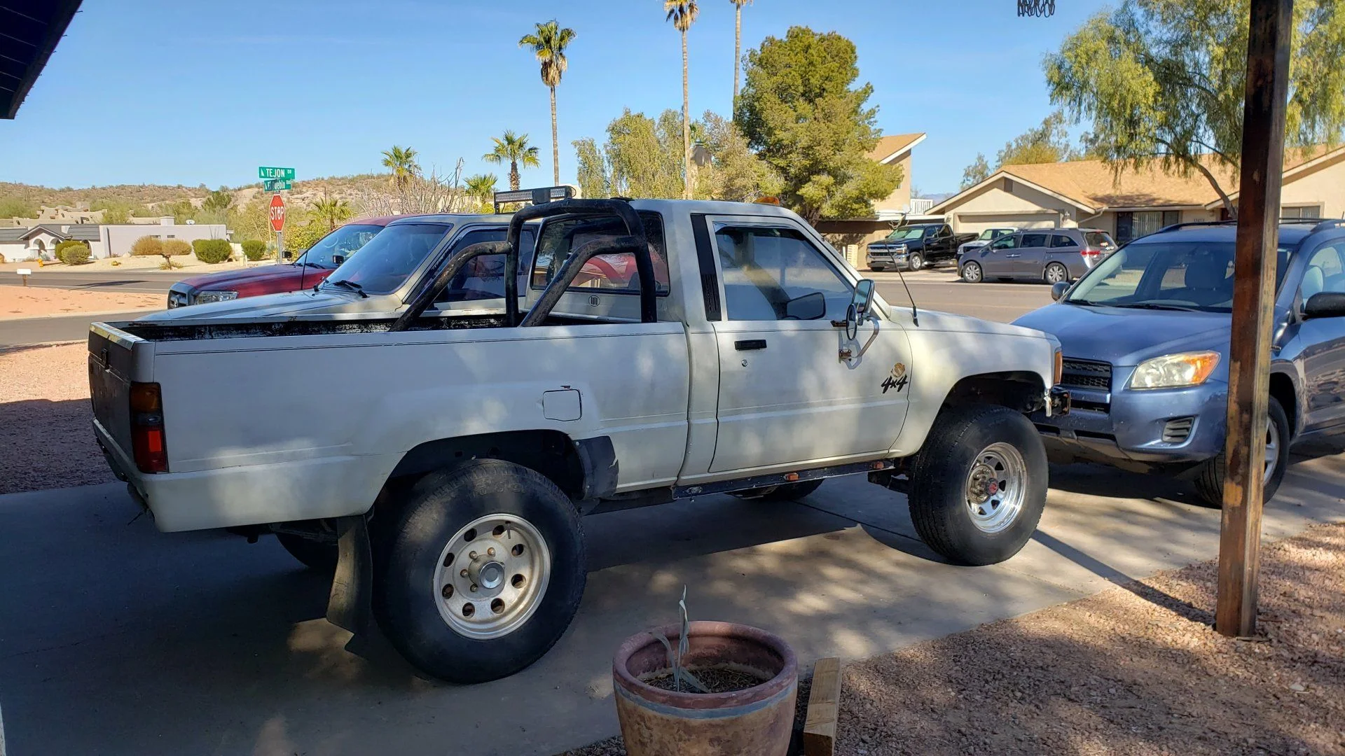

I acquired a 1988 Toyota 4x4 the other day, and it hasn't run in about 2 years. Other than pulling the plugs and pouring about a tablespoon of Marvel Mystery Oil in each cylinder, changing the oil and filter, checking the radiator level (still almost full), and a new battery, any other advice? I was going to leave the spark plugs out and go ahead and crank it over, assuming the starter works. Thanks!

Yes. Pulled the plugs, poured in a little MMO, let it sit for a day, drained the tank and added fresh gas. Checked for rodent nests in the airbox (none), changed the oil and filter (black), put in a new battery, cranked it over and made a hell of a mess with all that MMO gook from the open spark plug holes. Put the plugs back, hooked up the wires, grimaced and turned the key.
Runs great!
