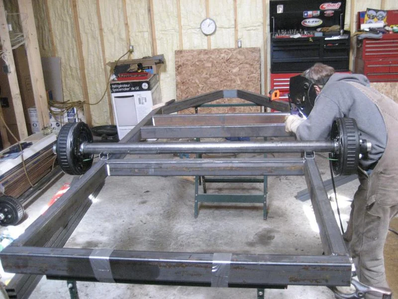

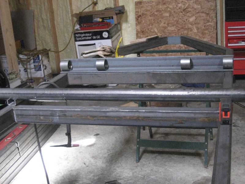

Here are a few more photos thanks the thread on independant suspension. Going to be riding on Slam Specialties RE-6 air bags, 3500lbs axles from Standen's with the electric brakes and 6 bolt patern to match the Cruiser, Hub Shells and bushing came for the suspension from "LT" at Metal Tech (which means that while I was getting them I also ordered Hyperjoints for the next cruiser project).
In the photos we got the first frame assembled, then used it as jig for the second frame, both frames still welded together.

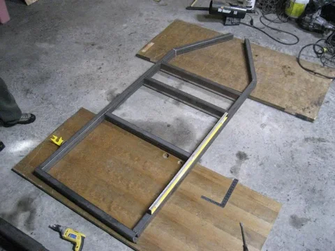

Starting the tailgate and built the second box. Everything is tack together, so I will be spending time on the welder getting all the seams welded up. Also need to weld up some brakets to mount the AirBags to the frame.
Holy light-speed batman!!!!:eek::eek::eek:
You're moving VERY quickly and it's looking great!
Do you have a brake that big or are you out sourcing your bends? Looks awesome, and light! :D
