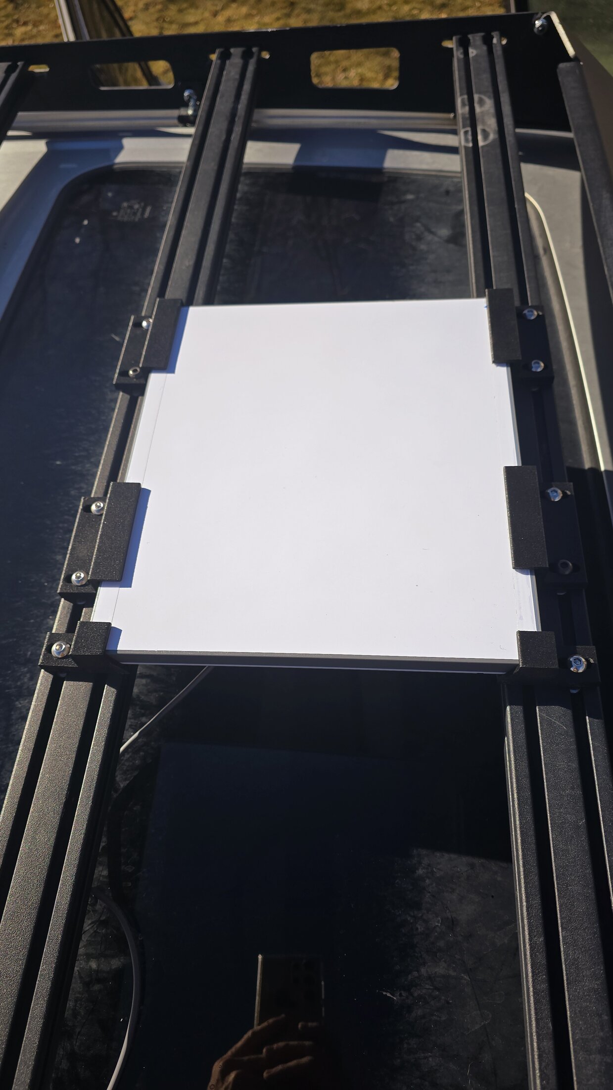

First trip out with the starlink mini. I have to say this thing is a game changer. We were in Wyoming and Utah and went through some winter storms and remote areas where we are always out of signal even with weboost. Having the mini was very reassuring. And the speeds, even while moving and in snowstorms, averaged over 120mbps. It's amazing technology and so easy to set up and install. My buddy and I fabbed a customer carbon infused mount for it that was rock solid, much more so than traditional 3d print materials and with much higher thermal and water absorption ratings. It was rock solid and the automatic snow melting feature on the mini comes in very handy.
I'm wondering now if this will make my weboost and even satellite comms obsolete. Not getting rid of anything yet, as I like redundancies, but the performance in very adverse conditions was very impressive.
I agree, our Starlink mini has changed moab and other trips forever. Any details on your mount setup?
Sure, I looked at and ordered what is available out there now and found the quality and build to be subpar for true overlanding and offloading applications. I didn't trust they could hold up over time so a friend and I designed this first version as a beta test for something truly more robust.
This also is designed to allow me to easily slide in and out the mini in case I want to remove it. You simply loosen the bolts on the small corners and rotate them away to allow the mini to be released.
We are in process on the next iteration which would include interlocking pieces (rather than six separate pieces) for easier installation and a cuved fairing edge for wind. We are also considering a way to allow for a couple mm of flex for shifting movement in the rack itself particularly during heavy offroading.
The material itself is PAHT-CF which combines PA12 and carbon fiber, offering low water absorption with enhanced mechanical and thermal properties, performing well in wet conditions. Its superior layer adhesion and flexibility make it ideal for engineering parts.

In my experience, limited thus far, the mini seems to capture a great signal much more efficiently and consistently than the original. That said, we designed the mount so the mini can easily slide out in the event i want to relocate it at camp. I keep an extra long cable in the rig for that but haven't had to do that yet. I don't use it for internet browsing at camp though.
