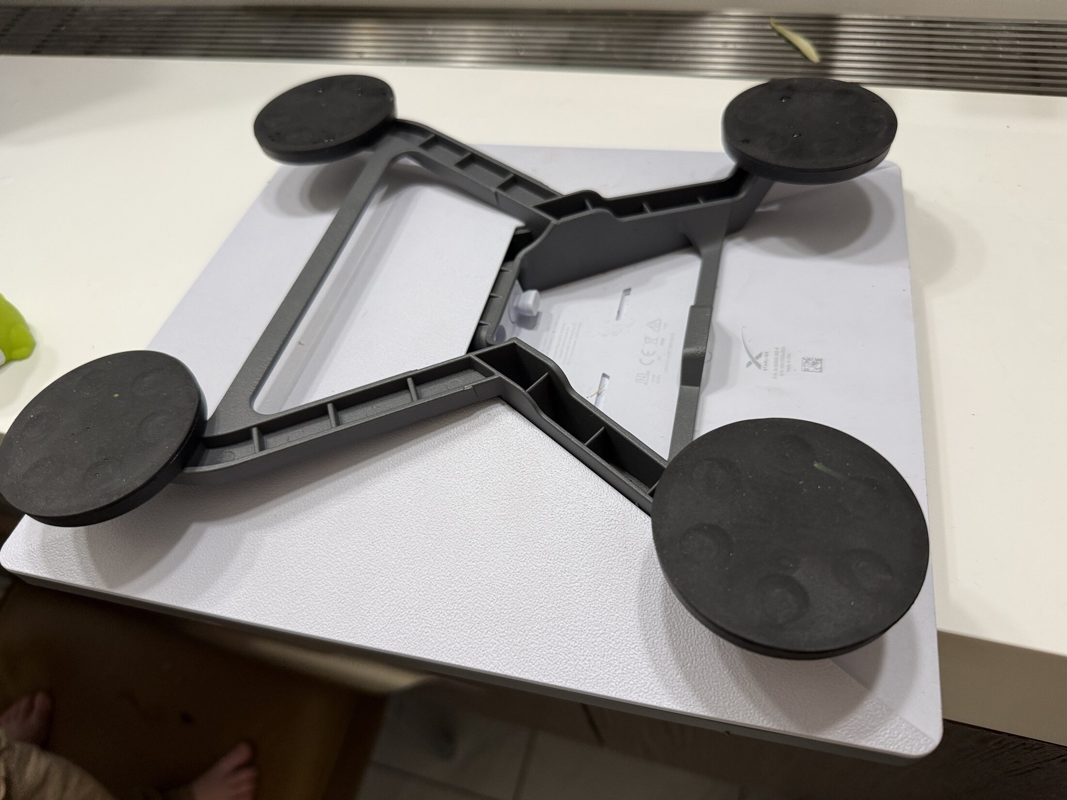

  1. Sunroof outside - via suction cups, will they hold ?
  2. Sunroof inside - via suction cups, no concerns except bumping my head. :)
  3. Roof rack - will the wifi punch through the truck's metal roof well enough?

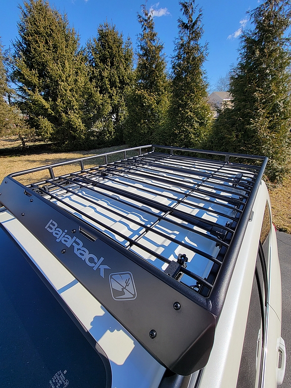

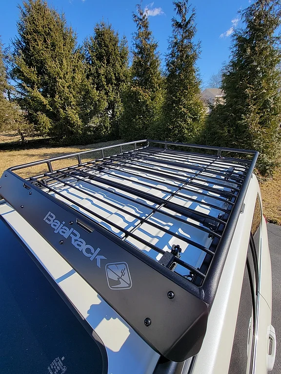

    1. The roof rack isn't solid metal, it's a basket type.

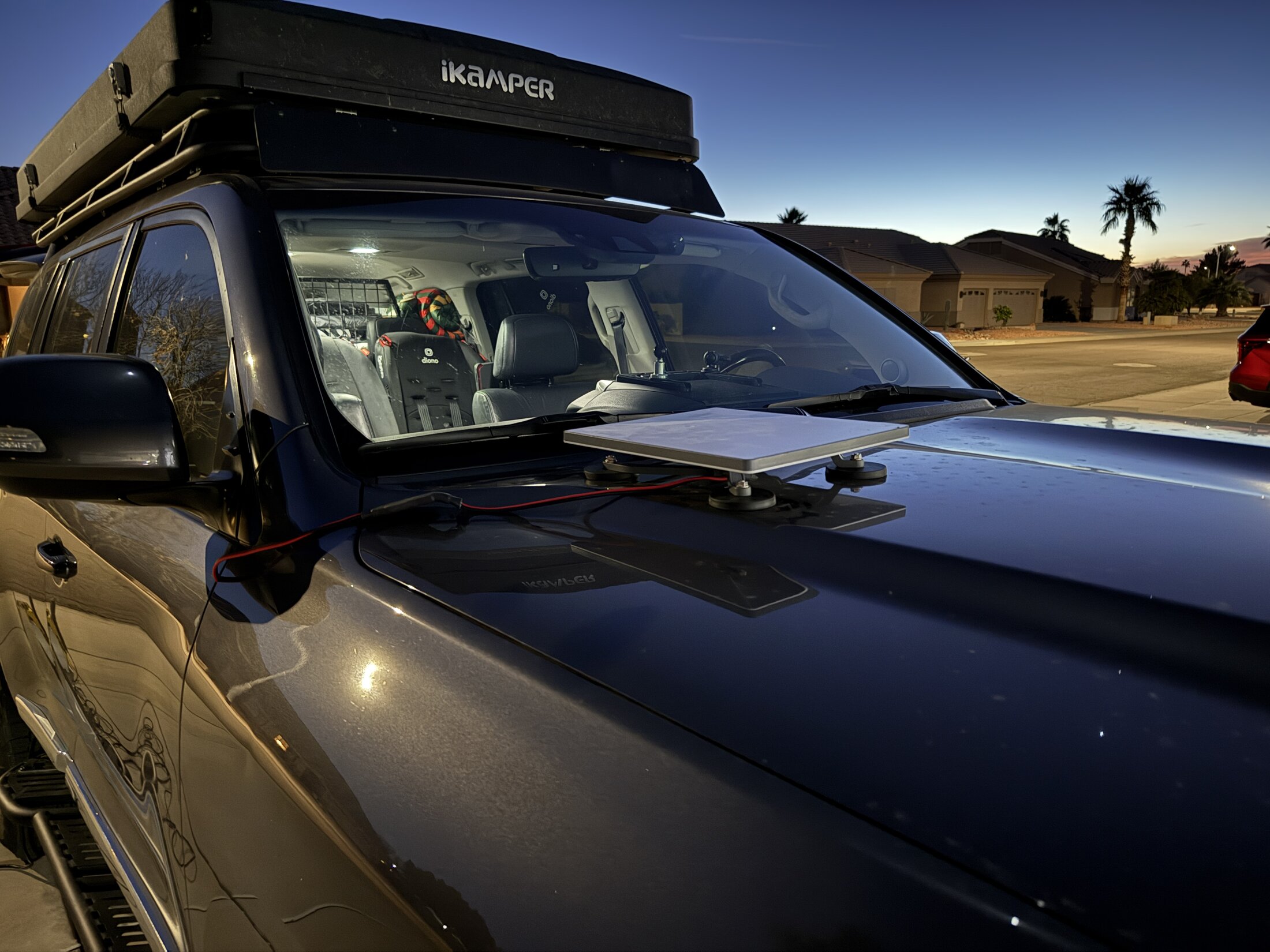

I just toss it on my hood with a magnetic mount, works great at 85mph and when wheeling. Highly recommend this route if you have a RTT and want the flexibility of moving it around often.

I never thought of putting it on the hood. DUH.
If the magnets hold at speed, well OK, it solves the security issue i.e. just pull it off the hood and stow it inside.
Also can move it to set it up easily in camp.
If I mounted it on the sunroof outside I guarantee that I would be looking up at it every 10 seconds to see if it was about to blow off. This would send my wife into orbit. She already hollers at me to watch the road when she notices I'm looking at the OBDlink temperature gauges. :)

It is solid as a rock, you won't be disappointed.

I’d trust the magnets over the suction cups. My mount is similar to @xeuxaz and it’s not going anywhere. That type mount does well on the ground or anywhere else for that matter, we have to get creative in the South because of the lack of clear skies.
