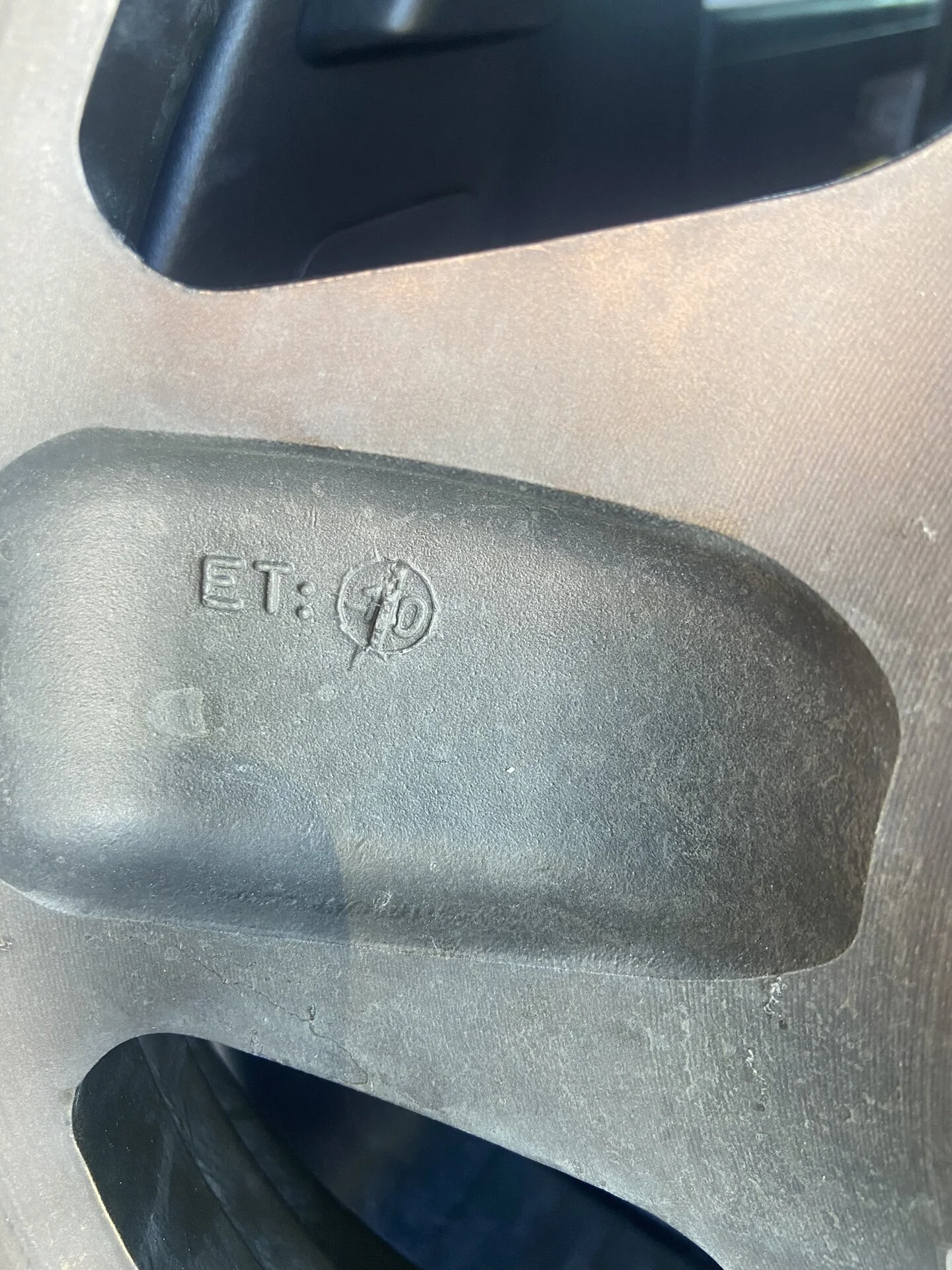

Your wheels "should" be stamped somewhere inside with something that says "ET" and a following number. Can't confirm for steelies, but all the alloys have it.
Picture below is an aftermarket SCS F5 wheel backside.
My stock 15X7 alloy wheels are -20 which is 3.21" backspacing. It varies a little. Maybe it depends on flares or not.
