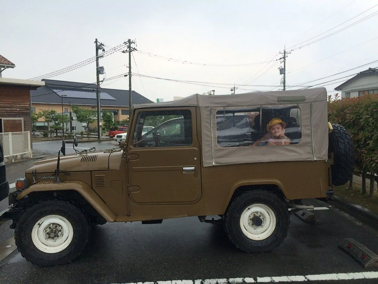

My truck is rated for half the payload of a 45-and usually holds little more than 2 kids, tools and some recovery stuff. I'll be pulling more than one leaf for sure. I'm going for a light rate then I hope to add airbags for when the truck is loaded.

Super cool truck!
