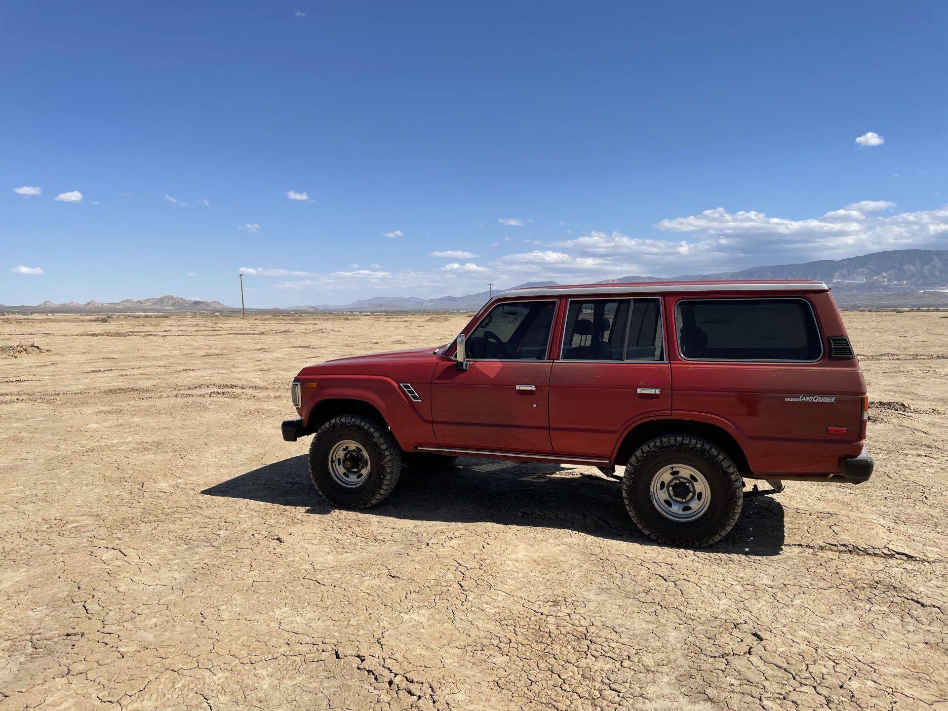

(since I know everyone likes photos, I’ve included one from Lucerne Valley)
