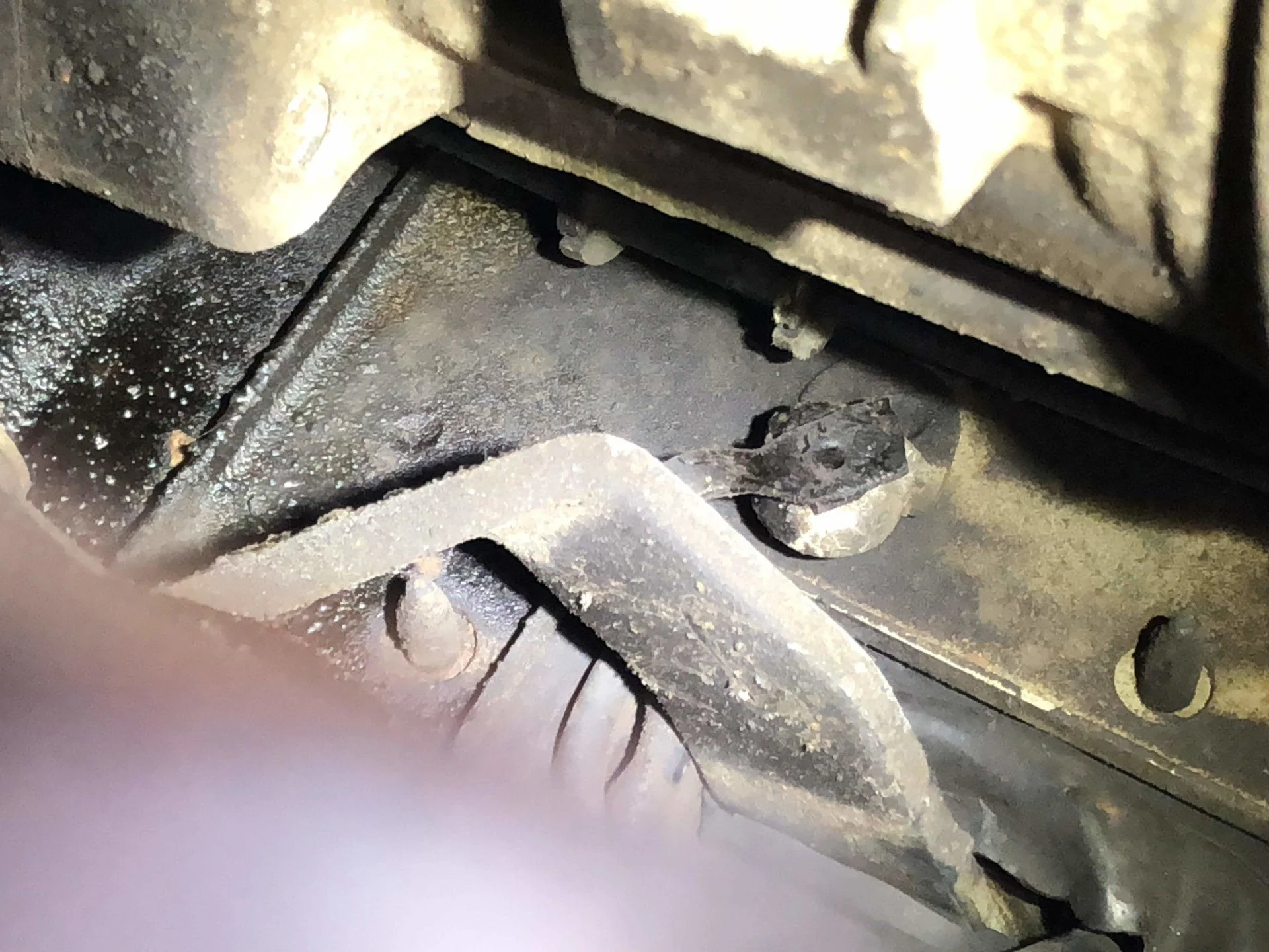

During recent work on my speedometer cable (gear oil in cable and speedometer due to bad o-ring and/or oil seal at transfer case) I broke the plastic clip (pictured) that holds the cable, which sits about mid-point, against the truck body above the transmission. Marietta Toyota looked up the part number and their best guess was 83791-90401. A web search turns up nothing and I had no luck searching MUD. Has anyone replaced this clip before or know the correct part number?

These things work as great cable ties. Snap into a hole in the body. Strong. Might work for the speedo cable? Don't know

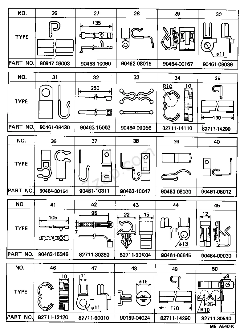

These come in many different flavors, the lengths are indicated on these diagrams:
