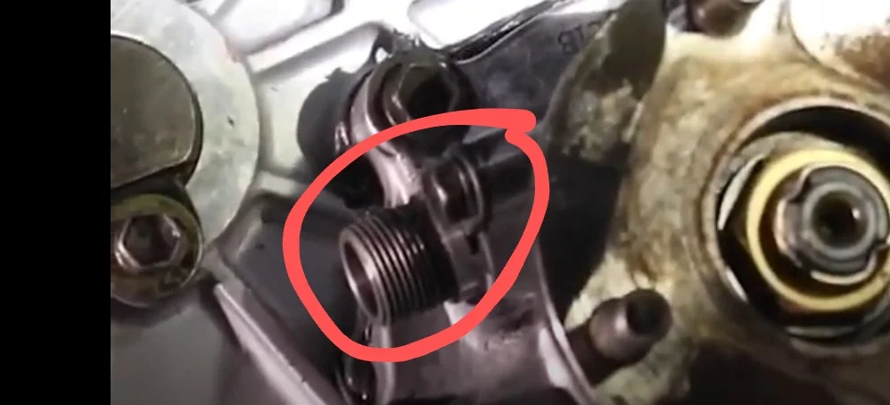

I'm assuming the bit in the red circle is not part of the cable kit, looks like it may be the gear driving the cable? My 80 series tcase (not this picture) just has a hole where that part sits. What is this part called?
33404-22010 is the outer speedo gear housing for the 80 t-case. There are several tooth count gears available.

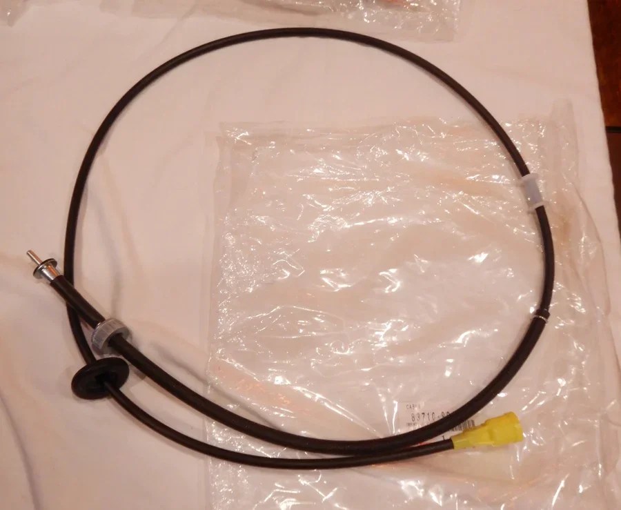

Part number for the FJ62 speedo cable that is longer. The additional length is needed because of A440F tranny is longer than a H55F.
I use this cable in both of my FJ60s that have a H55F because the extra cable length makes it easier to engage/disengage the gauge cluster.

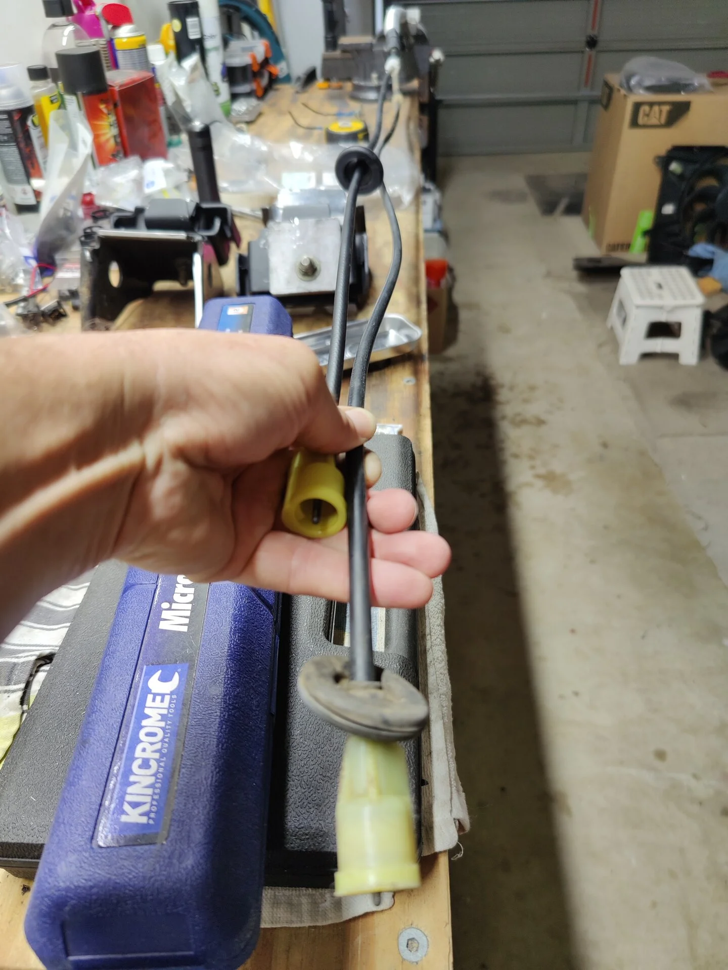

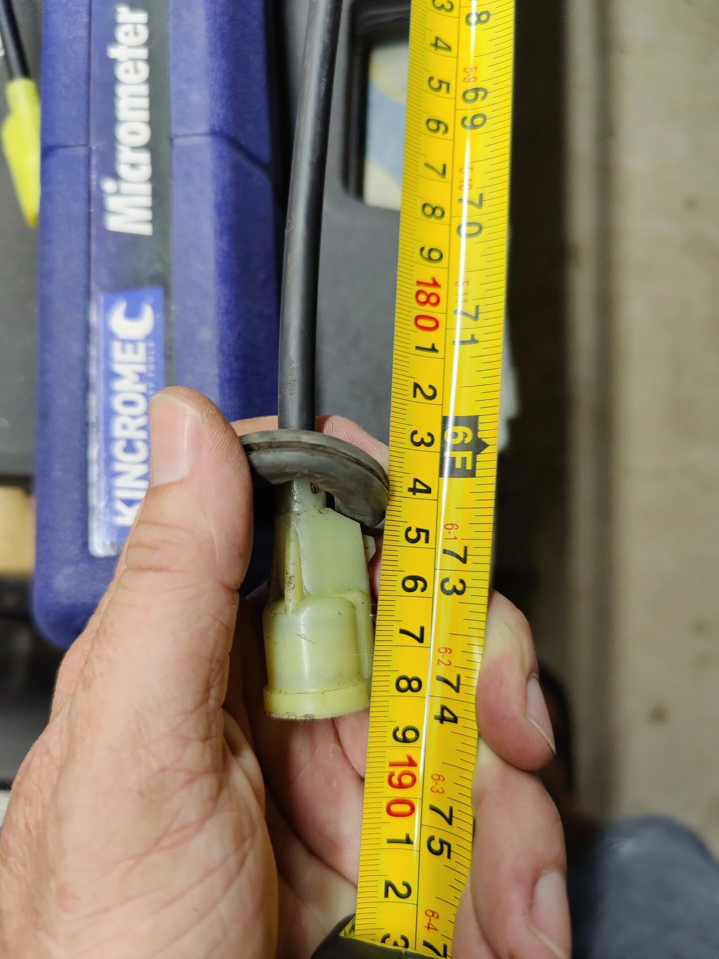

Interesting update. Just removed the speedo cable from the car and turns out that it (from the manual drive train) measures 74” and is 5” longer than the new one for an automatic transmission (83170-90A20). Anyone know what’s going on here? 🤔
