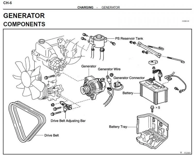

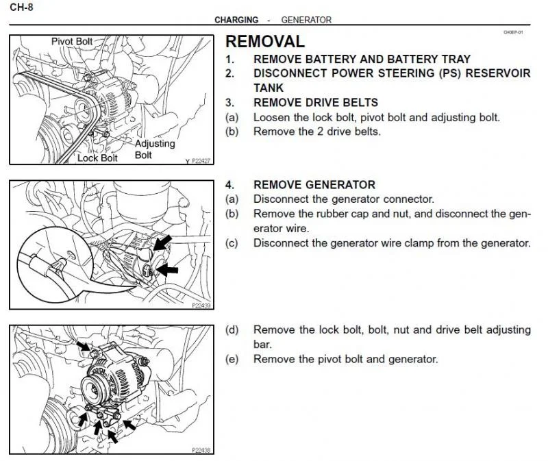

what year 80 do you have? These are pictures from the 96 FSM, which is 93-97. Have what you're looking for?

Nak, thanks for the diagram, it will help a ton, my store bought manual is about worthless sometimes. I will try my local NAPA, but, brought home some metric all thread and nuts to build one if I have to for now. I don't have any mo Broncs at the moment, although my son wants to build one when he is ready to drive. My last was a '76 with a full fam cage, a fuelie 5.0, lots of f/glass, prerunner bumpers, soft top and doors,and a custom aluminum dash. It was not a rock crawler, but, it was fun to drive fast. Now our toys are our dirt bikes, I have a KTM and he has a Suzook RM. Thanks for the response guys, appreciate it.
