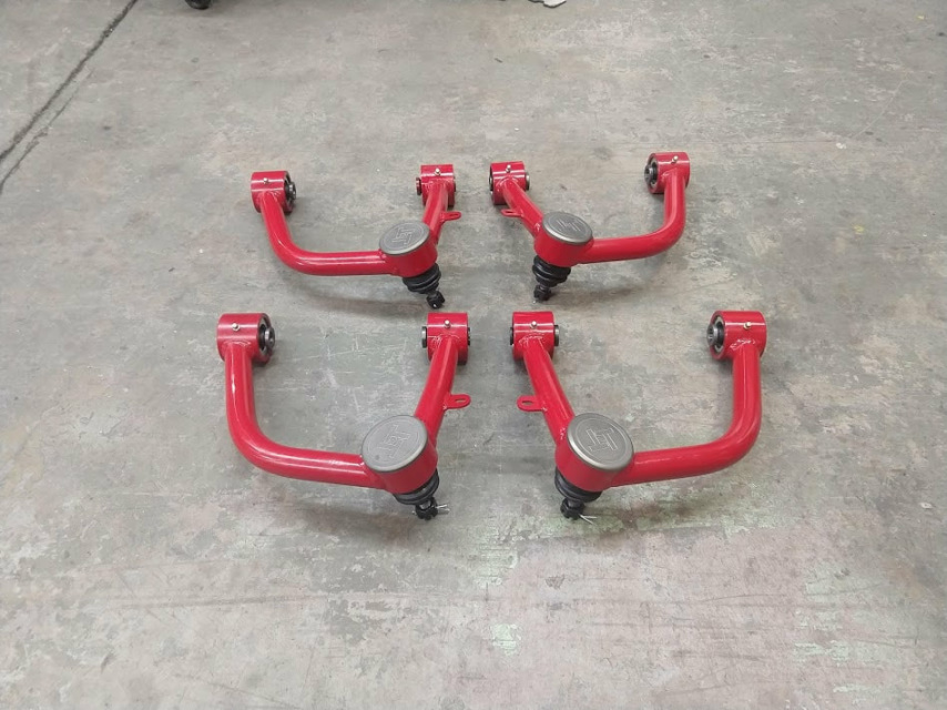

Trail Tailor sells UCA with sealed maintenance free ball joints.
Looks like @trailtailor uses a different kind of greaseable bushing for the UCA. Anyone able to elaborate on design and maintenance?
I’ve had SPC UCA on two of my previous 200 series because of the praise some folks on here give them and I think they are overrated. I am sure fanboys will jump all over this but I’ve never had good experience with them. I also wouldn’t own BP-51 either. Another over hyped product for a heavy 200. I have been running ICON billet UCA for the past two years and they have been absolutely silent. Most importantly, I live in a very humid climate like Angola and humidity loves to make everything squeaky. Not these ICONs(easy maintenance). I would personally run Dobinsons or good old OME in Angola over BP-51. The new Camburg billets are another excellent UCA option as well.
I've used the Trail Tailor UCAs for a couple years and can share a couple thoughts. I haven't had any issues with the sealed ball joint and the fixed caster has worked out well for alignments.
I've incorporated greasing the bushings into the 5k maintenance cycle along with rotating tires, greasing the driveline, etc. I skipped greasing the UCA bushings a couple rounds ago and did inevitably end up with some squeaking after a few offroad trip.
It's a pretty easy job especially if the tires are already off for a rotation. Otherwise, you can probably get enough clearance by jacking up the side you're working on. You'll need that clearance for access to the zerks (unless you install some 90 degree fittings. You just need to loosen the nut, apply grease until you see clean grease coming out of the bushings, clean up, and torque the UCA nut. I've figured out how to do it without removing fender liners but if you do I'd recommend having some of the non-reusable small white circular clips on hand. There was also one time I wasn't getting grease to clear on the forward side of the UCA and I needed to give the bolt a little tap with hammer from the nut end to back it out a bit.
