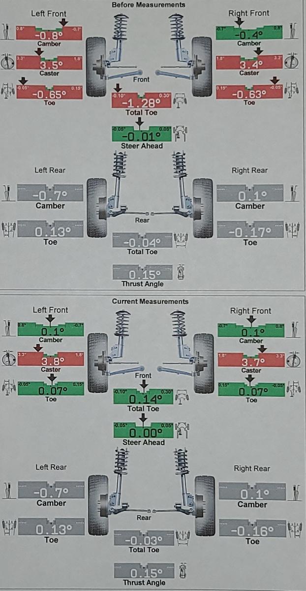

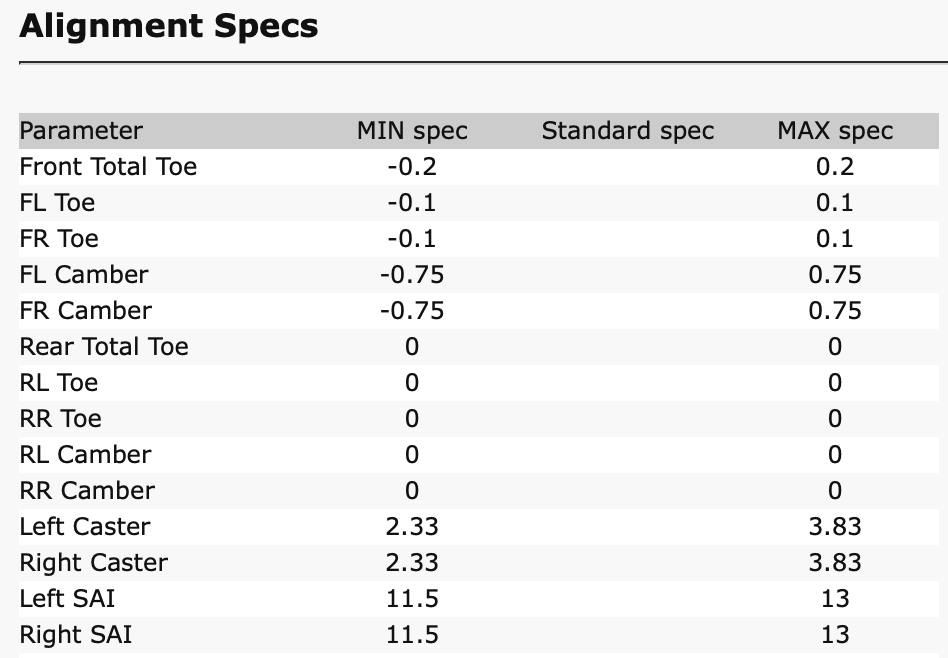

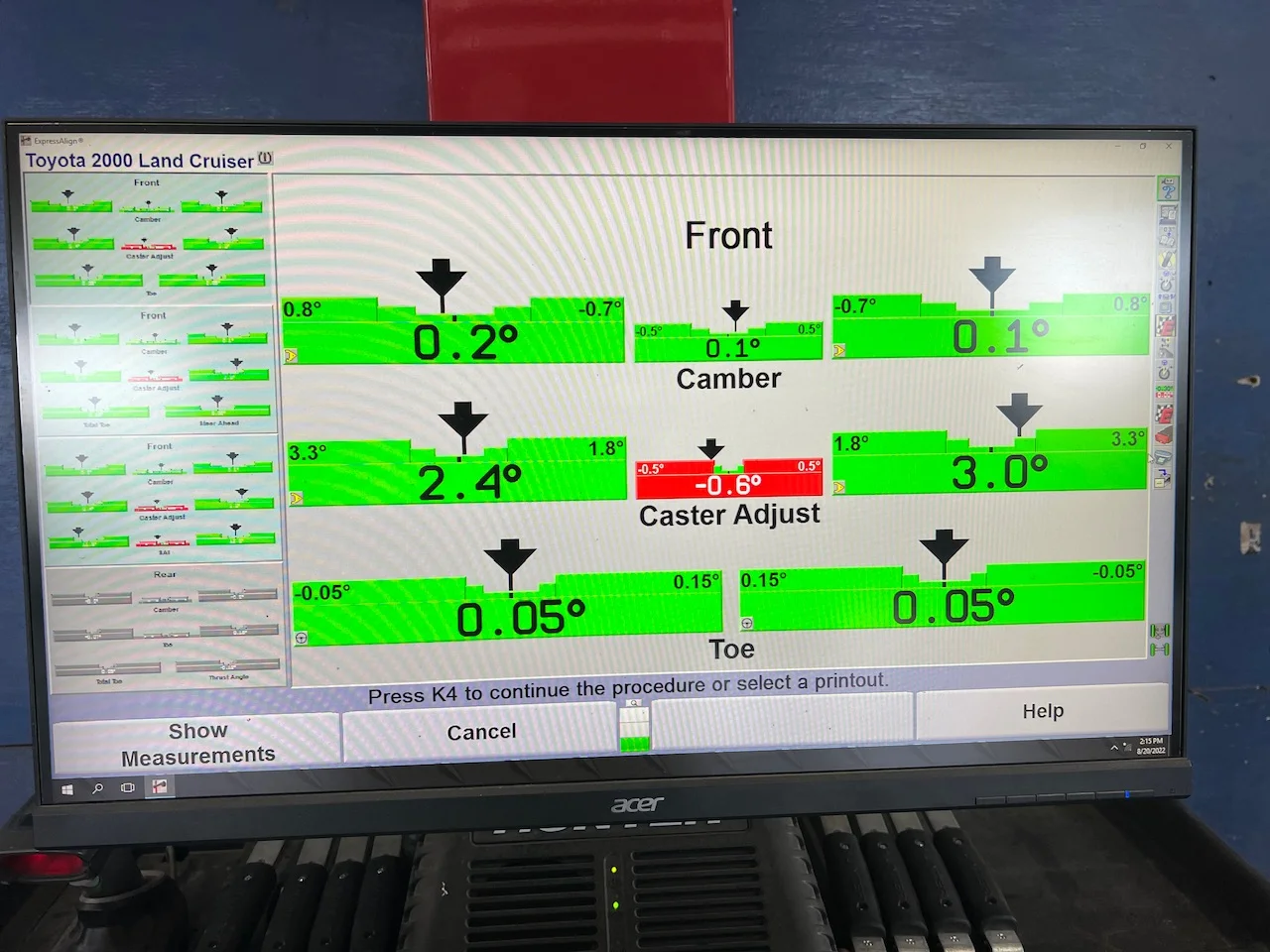

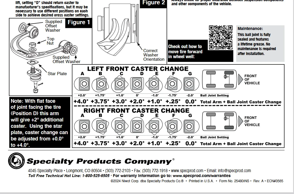

Mine.
Put the adjuster nut for 3-4 degres caster. I went with 4 and a breeze to drive on the highway. I have the older arms, which allow 0,1,2,3,4 degrees.
