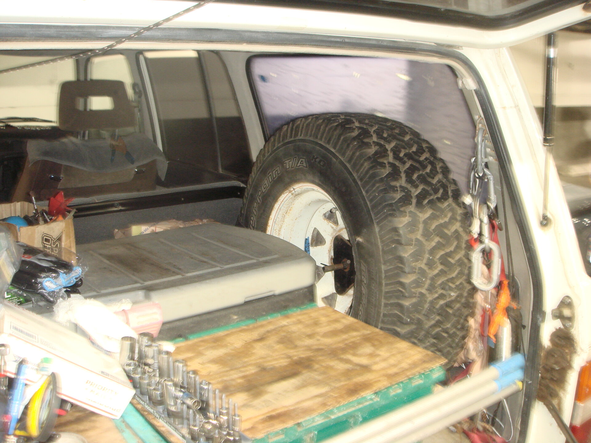

As I mentioned in my post- my vehicle was a FJ60, so it’s a bit different inside than the 200, but they both have about the same interior space. My experience carrying a spare really wasn’t vehicle specific because carrying a spare on the roof rack of any vehicle would suck - etc.
The spare holder I got, I purchased 30 years ago at sor.com. They no longer sell it. Its a very simple thing that looks like it was made in high school metal shop. It’s just an upright pipe that has two brackets welded to it so they can bolt to the side supports in the vehicle. There is a long threaded part on a collar that slides up and down on the upright pipe to extend through the wheel. A plate with a hole in it to accept the threaded rod clamps on the wheel and a nut tightens it up. Super simple but very effective.
I don’t have a good picture of it (sold my cruiser) but here’s a picture I found that shows the spare tire mounted inside. Normally I kept a tire cover over the spare. Its a 31/10.5R15 tire on a 15”x8” wheel.
