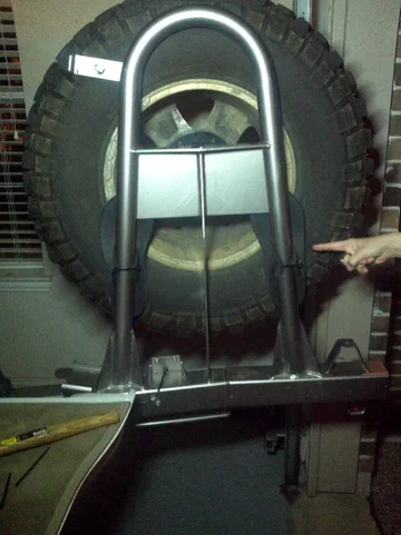

You have a pic? I was always curious about this and wondered why that bar didn't have a contour in it for the tire but never had a problem myself. What tire was it that you had the issue with? This is a bit disconcerting. It may be time to bring out the angle grinder.
We had a look at this. It was never like this. The upright was just a support and should not contact the tire. For some reason it has moved out a little and it touching the tire. The best remedy is to wrap the hoops on the tire carrier with some rubber tape (or cut a 1/2 circle of PCV pipe and tape it to the carrier) to thicken the tube in the three spots it needs to contact the tire. You just need enough so the flat bar does not contact. We are fixing this in the future runs. neoworms is the first case I heard of a tire actually failing. We have seen small indentations in the tire sidewalls after years of being on the carrier, but never cut a tire.

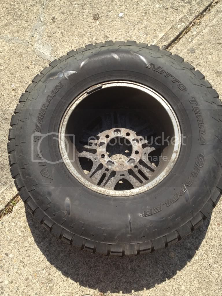

It definitely cuts into the tire. Christo, I would recommend Jon's suggestion of cutting a contour into that flat support to avoid tire contact. For the record, despite the shortcoming with the upright support contacting the tire, the Slee bumper is still king.
Neoworm, when you say it cut the tire, are you saying that it actually cut through the sidewall? Or just left a mark?
It cut the sidewall. The tire is still useable but it is definitely only a spare now. I will post up a pic after my morning coffee.

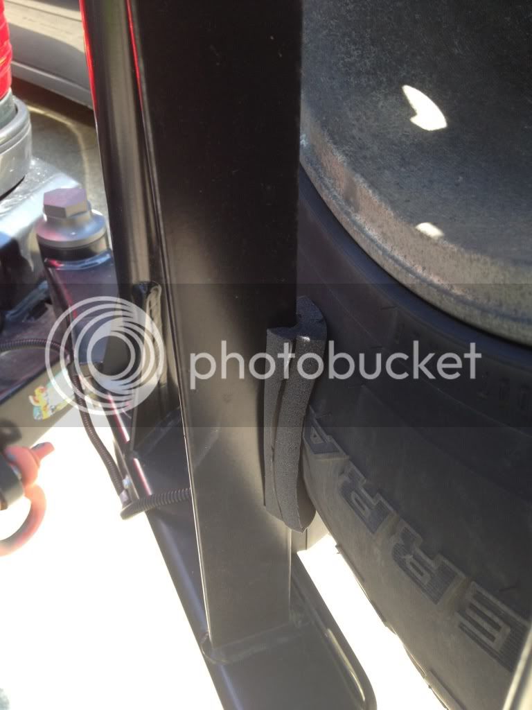

Pulled my tire off to see what this was all about and discovered minor rubbing on my spare (nothing to the extent of cutting the tire). The worst seemed to be that straight bar support vs the hoop. You can see the various spots where the tire makes contact with the carrier so I just put thick door/window foam insulation in those spots, and doubling it up on the bar support. Not sure if this is a lasting solution but it will do for now.
Spend a few days on some seriously washboard roads and that foam is going to be useless.
I agree. I think Christo's idea of PVC pipe sounds more durable.

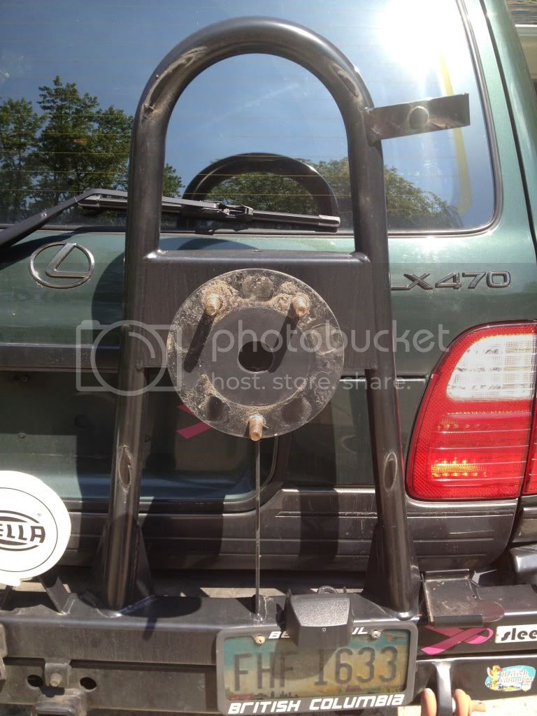

This is about how much we want to see the tire sit on the carrier. If anyone is prepared to drill and tap the tubing, then we have the rubber stoppers (like the one used on the carrier arm to stop against the bumper) that can be installed on the tubing. That will move the tire out about 1/2" and there will be no issue. Also it will then be rubber against rubber.
Just contact me if you want some.
Otherwise I would suggest wrapping the round tubing to increase it's OD in the spots where it touch. That would also move it outboard.

Yes, just checked my older single, centered swing out. There is actually a 1cm gap between the center support and the tire. If I had the newer version, I think I'd do just that, clearance that support a bit.
