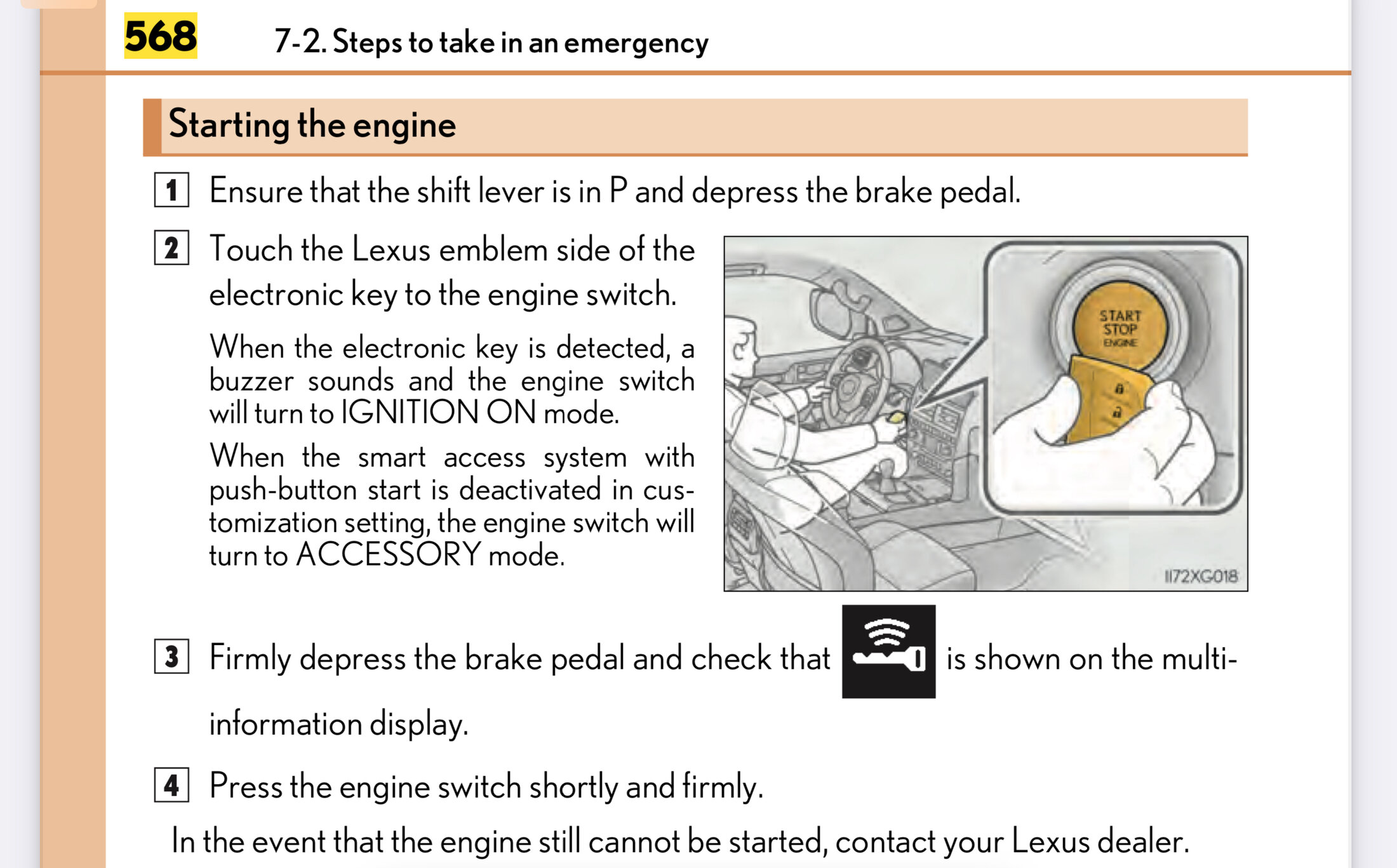

You should be able to hold the dead fob against the Start button
Nothing is changed for vulnerability. Faraday bag for your FOB(s).
I can confirm that you can start the car with a dead fob as Acrad's shot of the manual shows. My fob's battery died while I was on a trip and I had to do that to start my '17 GX. The backup theft prevention system is separate from the rest of the fob. It is an RFID-like one where the "chip" in the key gets its power from the radio signal that the reader in the car is using to talk to it. It does not use the remote battery. Older cars without push button starters used this system all the time- the key in the ignition switch was always within range. Now with keyless entry and push button start, it's a backup for when the remote fails.
