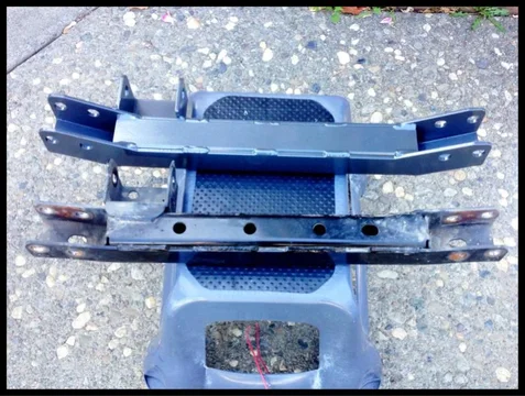

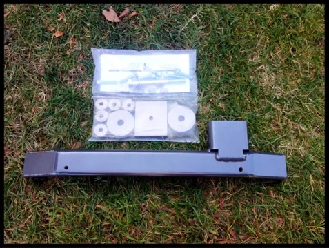

I doubt they would get there faster than ordering from Slee but superior engineering and snake racing over here have diff drop kits for the 100 series. I can tell you first hand that the superior diff drop kit looks very nice and they have fantastic customer service.

I just got a Slee diff drop kit from Cruiser Outfitters. They shipped right away and service was excellent. Once it arrived, it bolted up without any issues... another good Slee part.
