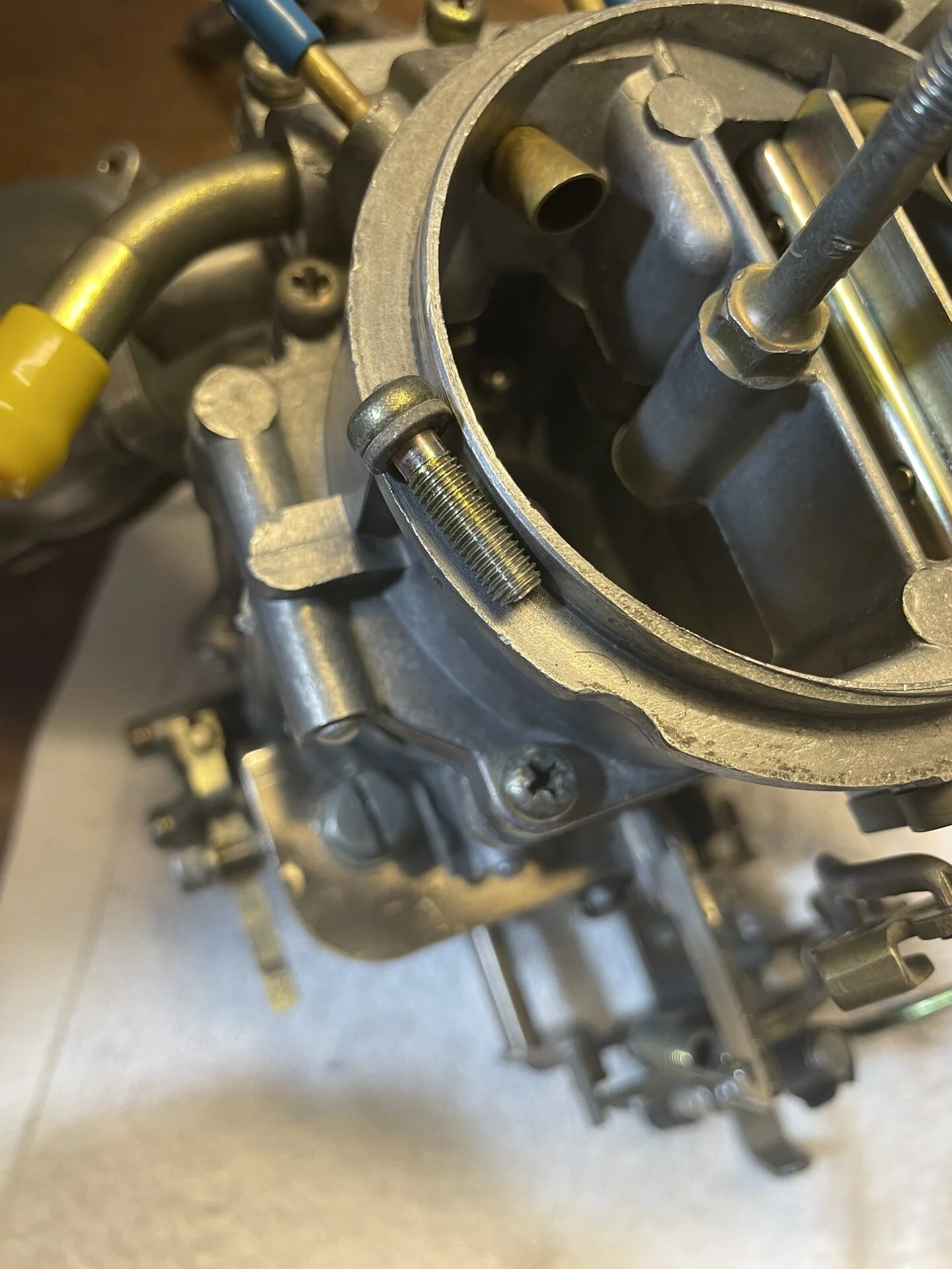

Been searching and still searching for a source for the pan head screws that hold the top of an Aisan carburetor together. Couldn’t find the perfect screw in McMaster-Carr’s inventory?
Thanks for any help!

Only downside is that CR uses non-captured lockwashers.
Something like this is more ideal in my mind.
Or if you want to dig further:
I like those JIS screws with the captured washer.
Is that what you use?
I prefer junkyard hunting for oem hardware and having it replated but for new I usually go Toyota since the air horn screws are available, albeit bright chromate. Otherwise yes I order from 3rd party like above.
