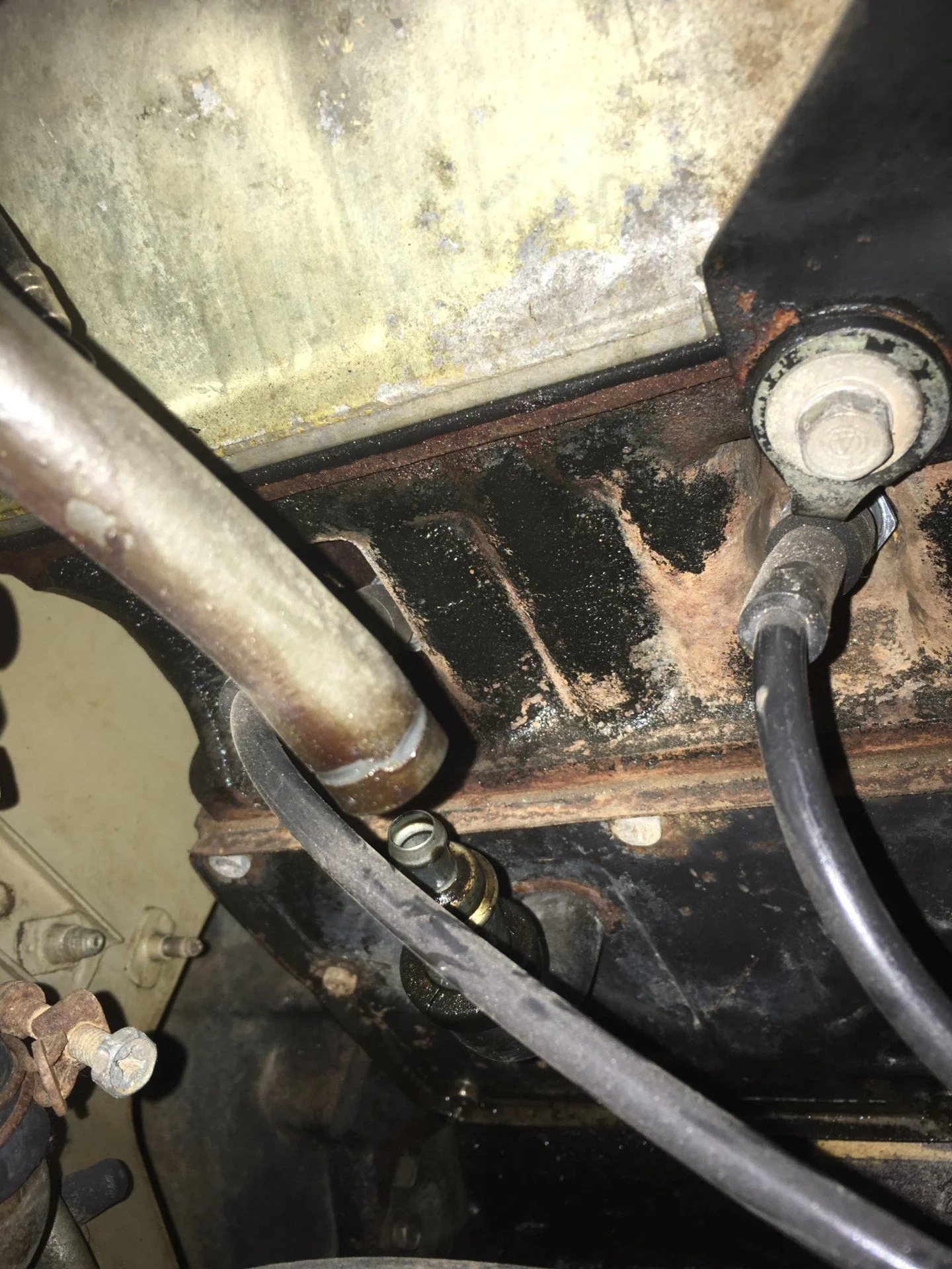

The hose that leads from the PCV valve around the air cleaner to the manifold was disconnected.
Yes. If you're running good with that vacuum leak you've got a carb problem.
View attachment 1731468 The hose that leads from the PCV valve around the air cleaner to the manifold was disconnected.
