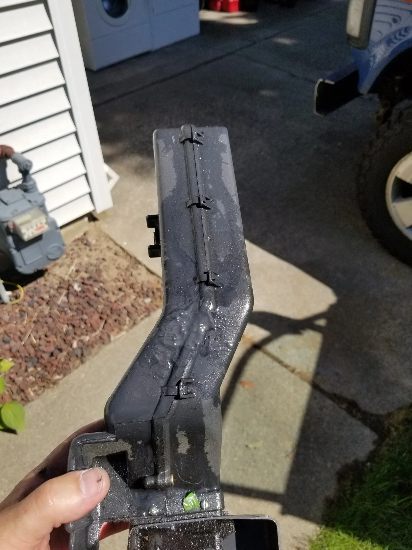

Cleanup of the mess, however, was a major chore. While my speedo cable was detached, I pulled the cable itself out and pulled apart my dash. I flushed about half a can of B-12 Chemtool down the speedo cable housing to rinse out the oil and contaminated graphite grease that I had lubed the cable with a few years ago. Since I was taking time to do other stuff that evening, I left it hanging loose overnight so all the Chemtool could evaporate out. I first pulled my lower air duct assembly so I could clean it out, and it was pretty gross. I completely disassembled it and soaked it in a 5gal bucket with about 75/25 water and Purple Power overnight.

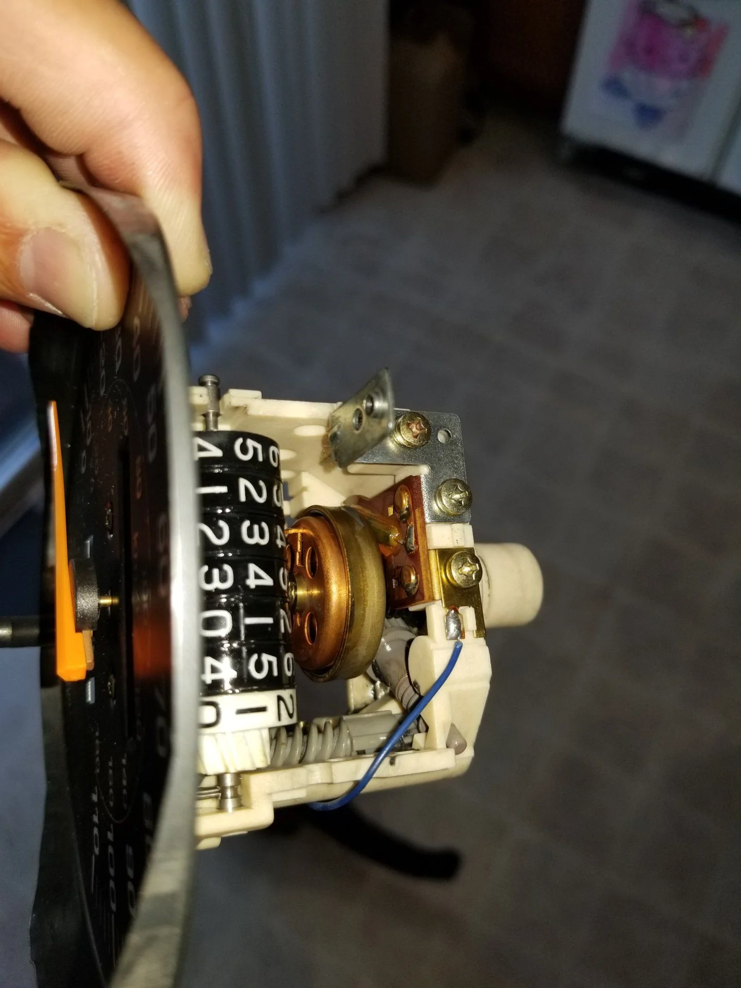

While that was going I pulled the speedo off of my instrument panel and got the crazy idea to pull it apart and see if any oil had gotten inside. Oh it was worse that I suspected it would be.

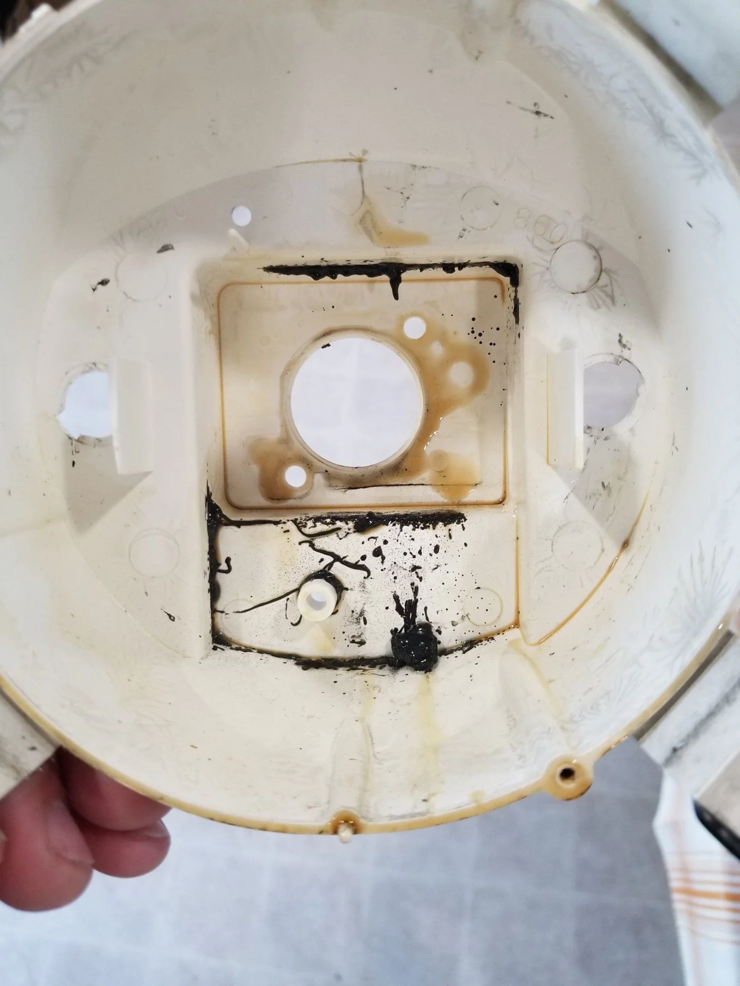

Oil had definitely gotten into the housing.
This doesn't look encouraging...
Dude, damn.

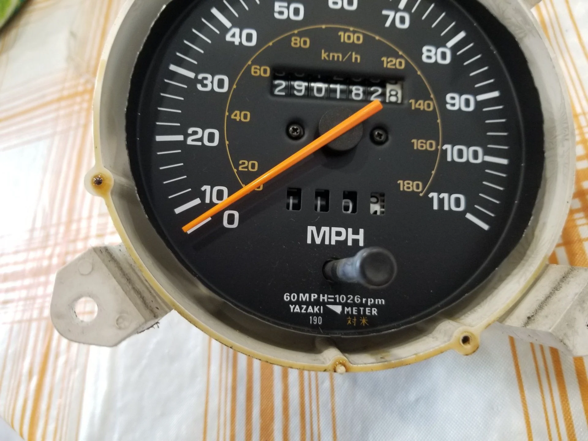

Speedometer after cleaning. Looks much better.
When I got everything all cleaned up and reinstalled, I relubed my speedo cable and reinstalled it into the housing. The speedometer itself behaves MUCH better now, and it solid as a rock, for the most part. Unfortunately there is no saving my cable, and it shows the telltale signs of a cable ready to give up. At about 60-70 MPH my needle will randomly jerk down to about 40 and bounce right back up. Most of the time it'll hold nice and steady, but the cable is definitely on its way out. Nice to know that I recovered the speedometer itself though.
