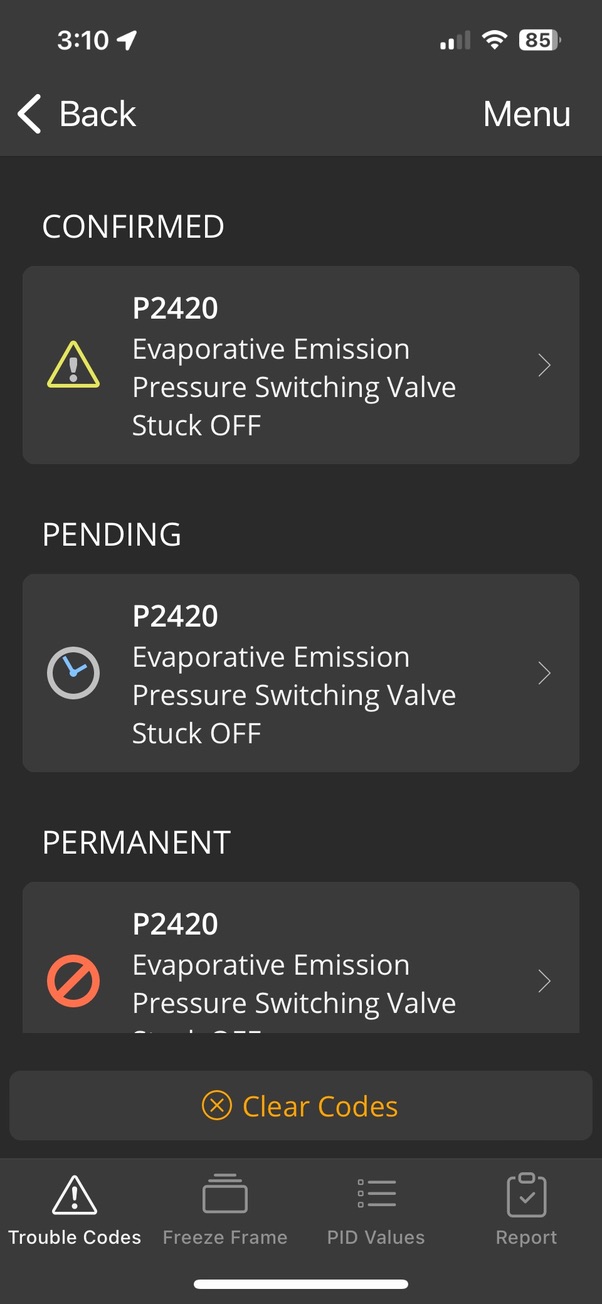

Posting up here to see if anybody has had any issues with getting P2420 codes overnight and/or has gotten a P0441 code while driving WITHOUT a modified fuel tank/aux tank. I recently moved to NC (sea level) from UT (5000ft+) and ever since moving here, maybe once a week I'll get a P2420 code. Since having the 200 here in 2024, I have gotten a P0441 maybe 3 times randomly only while driving. I have replaced the fuel tank cap (OE). For what it's worth, I bought OBD Fusion with the car specific stuff and I've attached a screenshot of what it looks like on the rare occasion both codes pop.

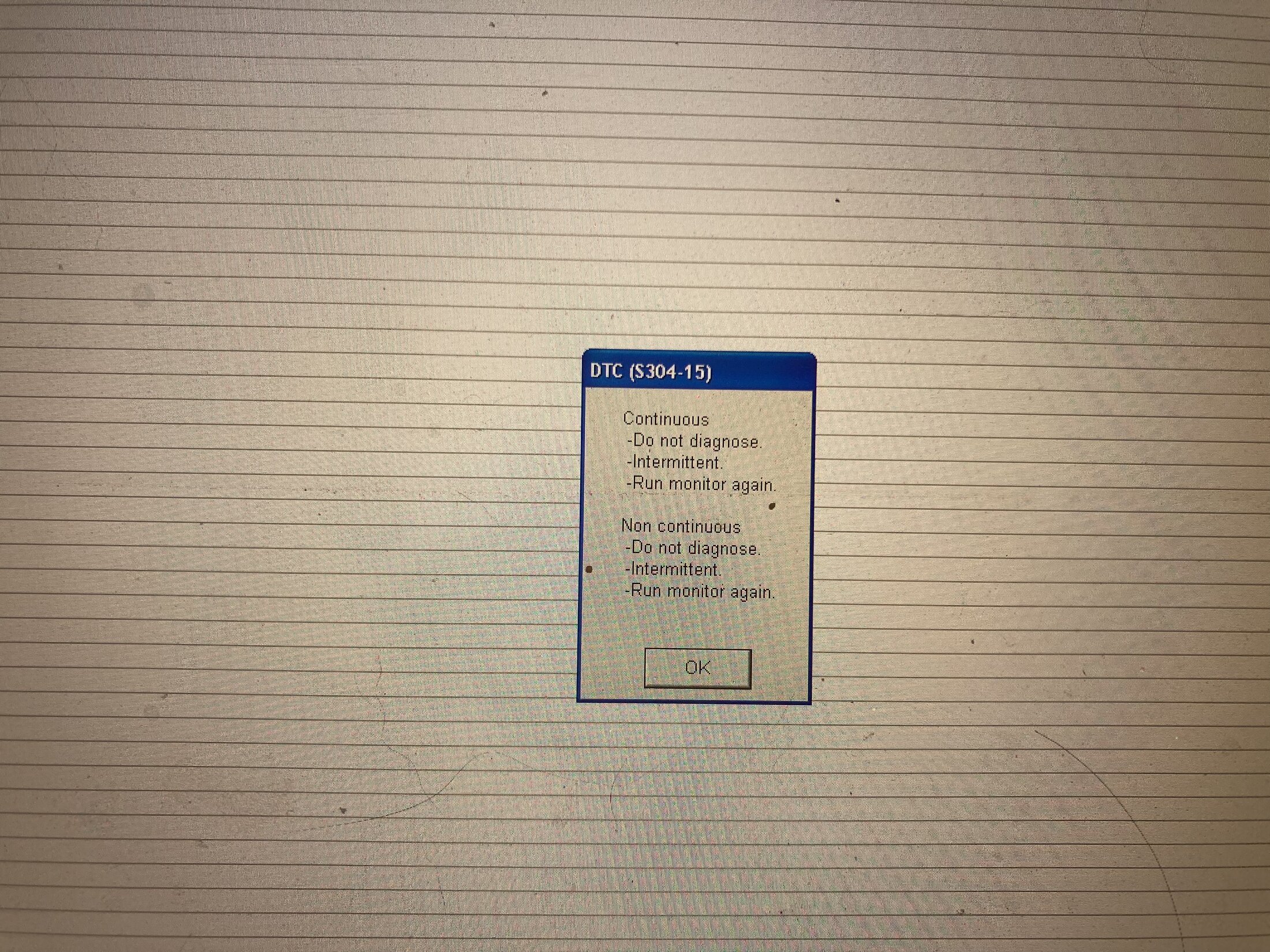

Got a P0441 for the first time since replacing the charcoal canister. OBD fusion just says "incorrect purge flow". Techstream just said this message:
Going to avoid clearing my DTC and see if it self clears (maybe calibrating?)

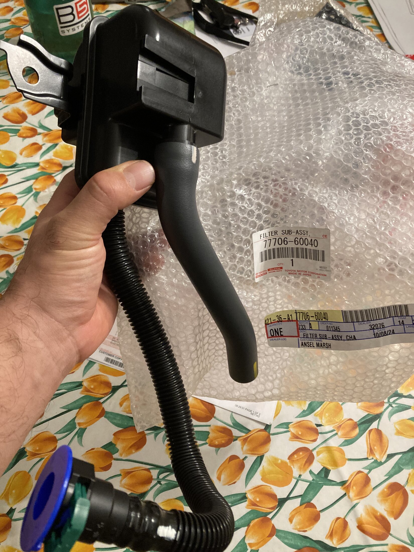

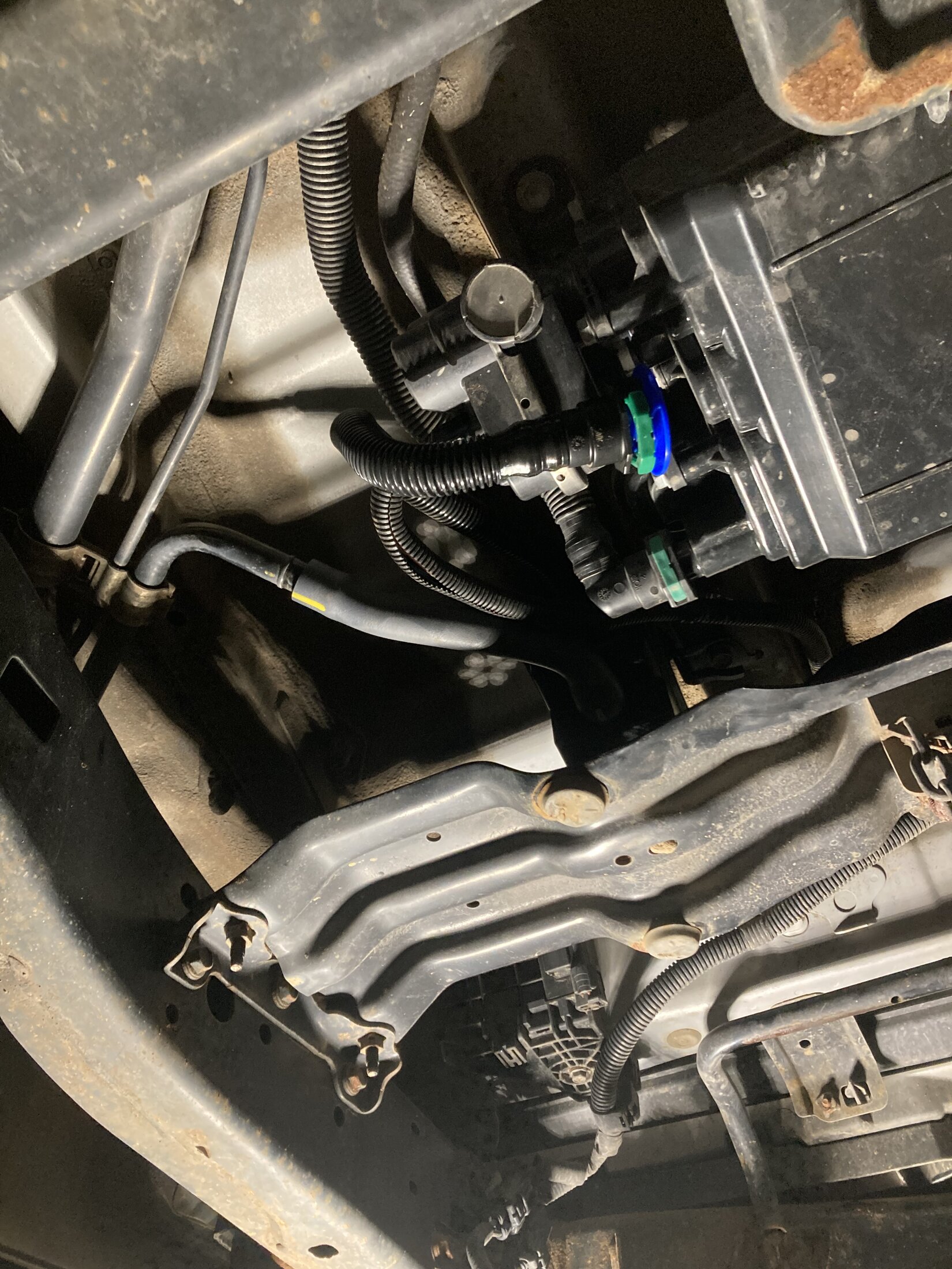

I went ahead and just bought "Charcoal Filter Sub-Assembly" 77706-60040 (labeled as canister filter in photo 1 and 2) with the guess that it's clogged up and not allowing enough air to return into the system when the post-5hr-leak-check is conducted. Didn't see any specific instructions (yet) on the manual for how to replace it, but i'm assuming it's fairly accessible like the charcoal canister.
Hoping to put this in this weekend and see what’s up with the old one.
Good news: that’s a brand new paper filter assembly that’s part of the breather system (iirc) -“canister filter” per the diagram above.
Bad news: per some of the conversations I’ve had, it’s not REALLY needed for the system to function.

While I was down there I did notice the wires that connect into the cannister were looking a little exposed, but at this point I think i’m gonna just hand the keys to the toyota dealership…
