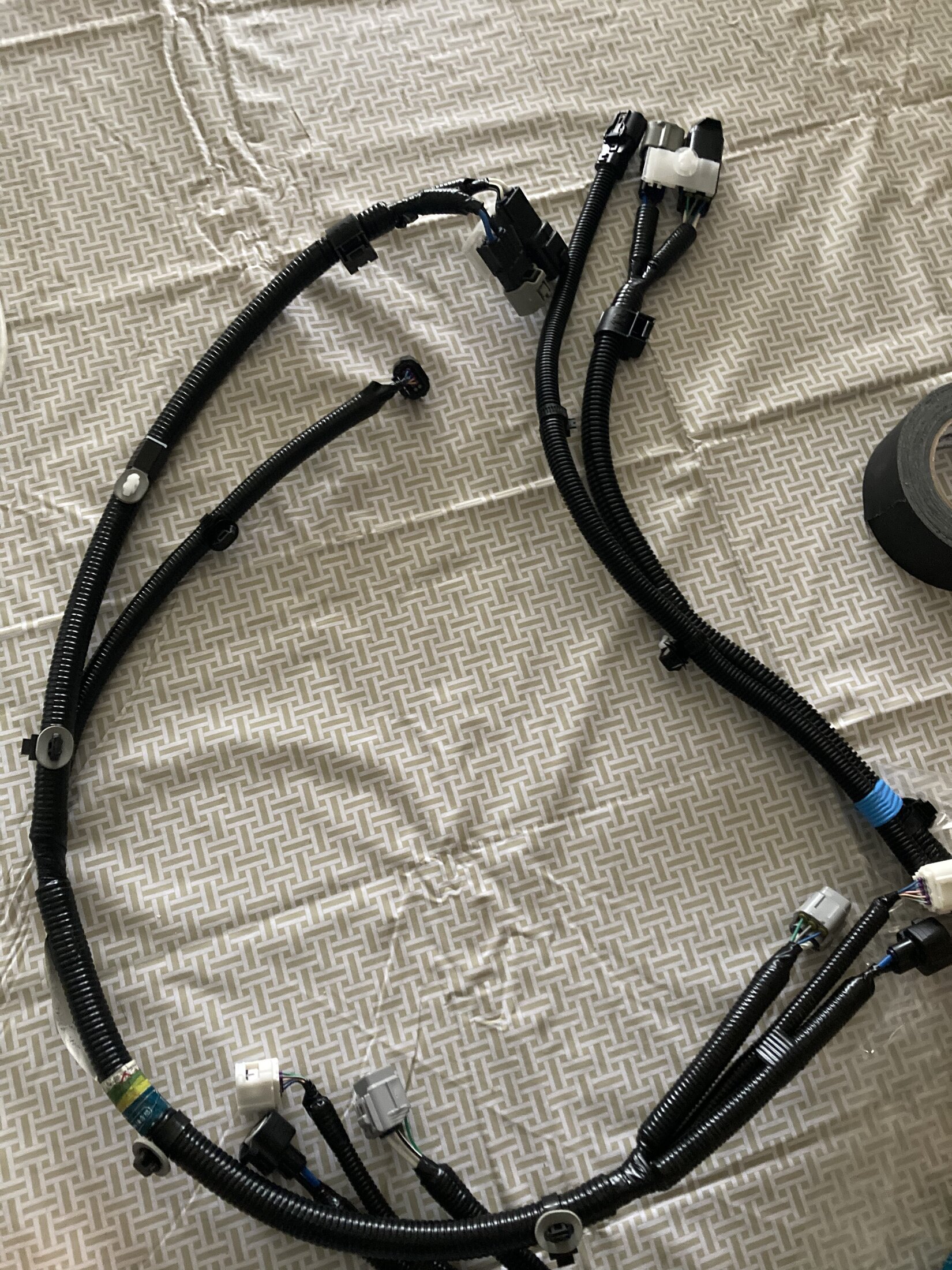

I spoke too soon. Did a continuity check on VGND (black) and there's a break somewhere in the harness. Just ordered a whole new harness (82163-60421) for that whole rear area. If anybody knows the P/N's of the little pop-in-ziptie parts back there, please let me know.

Looks like I solved the issue. Drove 3000mi over the holidays and had zero CEL/MIL light. Ultimately the problem was a break in the VGND (black) wire caused by corrosion secondary to water/dust intrusion into floor wiring harness #3.
One thing I did notice when I got the replacement harness is that the superseding part number for floor wiring harness #3 (82163-60421) does not work with older 200 series. I think it has to do with small differences in the charcoal canister between the years, but both where the wires are in the harness and the overall length of wiring made it incompatible with my 2009 model.

82163-60420 on the right, 82163-60421 on the left. Notice how the female black end is longer on the older model going past the trailer control harness.
