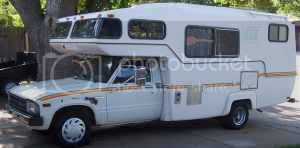

Here is the beast that will soon receive an FJ80 solid axle swap.
It is a 1983 Toyota sunrader 21 ft motorhome with a 22R and 80,000 miles on it. interior is what to be expected from a 30 year old ride, Previous owner began renovating it and didt finish- I have a clean slate for rehabbing/updating everything.
The sunrader was the best motorhome conversion by far due to its 2 peice clamshell design, it is less prone to leakage as some of the other 18-19 motorhome companys that did Toyota motorhomes.

Interesting:hhmm:. My Father-in-law ran a Toyota mini motor-home for about 10 years back about that vintage, not sure if it was the Sunrader or not. Might be able to tell after you post some interior pix. Does it expand up? He took it back to the East Coast at least twice and all over the place. For road agility, his, pretty much, went like a bat out of hell. Surprised me how well it went. You might want to re-think the skinny tire approach. Try it, you can always change tire sizes. Isn't the OEM axle a FF? I've seen farm rigs and some semi's that should have been running duals, but actually have a wide single rim & tire setup in the rear and go not quite as wide in the front. Better flotation and weight bearing, I guess. Good luck with your project :cheers:
It is a full floater rear end, the dual part is about safety more than anything, thats alot of weight to blow a tire on the highway and have to carry 2 full size spares. you can drive on 3 rears in a pinch and load carrying and handling are so much nicer with the wide foot print.
With that said, this will see no "trail' use, off roading etc. this will be for maybe an occasional hard to get to place to camp or hunt, the ground clearance will be nice and once in awhile a little snowy road or dirt track
Yeah, after reflection, a single spare that would go front or rear makes more sense and the rear duals would probably be safer in a pinch. In your pic it's kinda hard to tell, but it looks like there's a joint in the skin that would allow you to crank the top up for expansion for more head room. Is that the case? You mention 2-piece clamshell design and just wondering.
