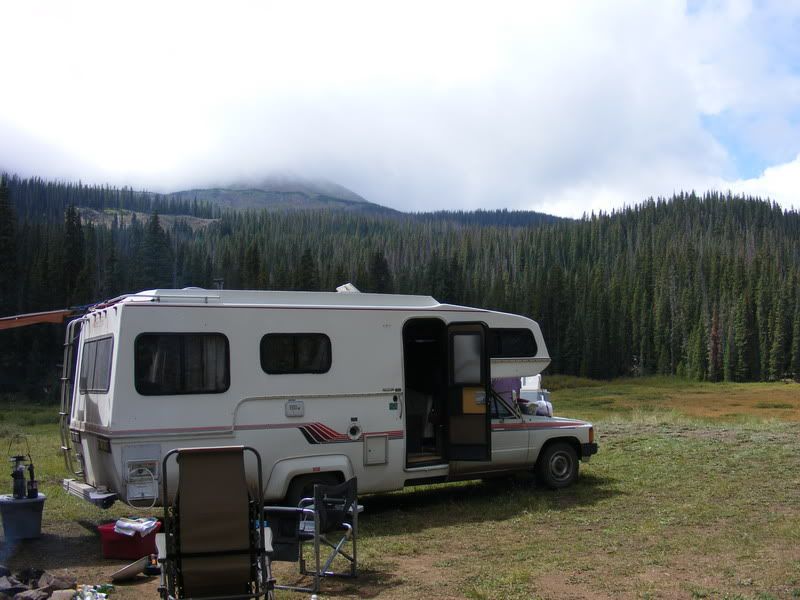

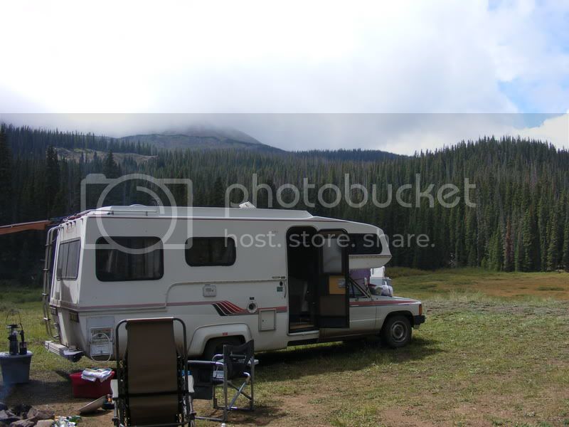

Camped deep in the Rio Grande NF, Colorado, at 11,700 feet.
This is far from the whole story - other upgrades have been made and such things are a perpetual work in progress anyhow. It's a mean, dependable, comfortable, low cost traveling/camping machine that can tackle terrain and conditions that may surprise some of you. We were slobberingly hellbent on keeping this rig forever.

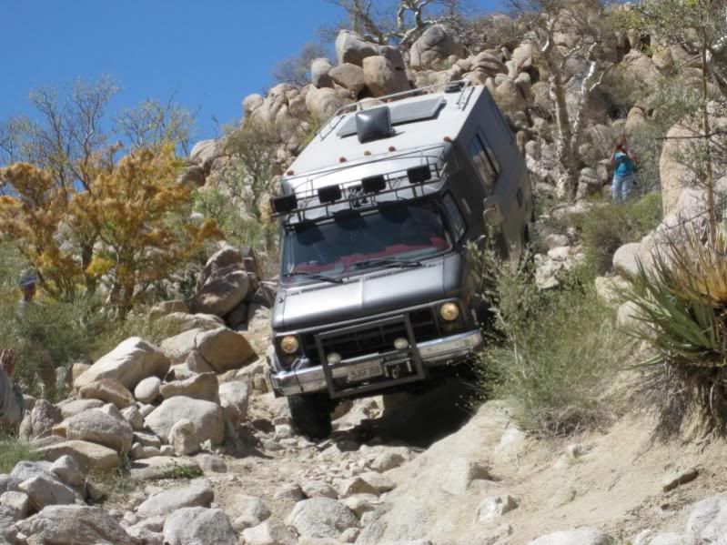

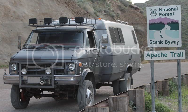

Blinked my eyes and next thing I knew I was in Arizona, shellshocked like a mofo, handing a cool dude a wad 'o dough in line with what a nice guitar costs. Later that night I got attacked by a pit bull inside a Walmart as I bought gear for the drive home. It's funny how a simple Google search can suddenly change one's life, it seems.
I beat the tar out of the thing on the way home - lots of 4X4 roads in AZ. Note the grille askew in the photo. It smiled and begged for more. The quality of the 4x4 conversion is superb, and a 1998 Vortec 454 was daringly hacked into the clean, straight, 1979 GMC 3500 chassis. Say hello to "Billy".
The interior was actually pretty decent, but I've ripped it out like I did before and am building it into an unstoppable, ruthless, onroad/offroad psycho rampage road tripper with the greatest level of comfort and sophistication I've ever attempted on a build. I think it'll outdo the ER at about 5% of the cost. Yowza! That'll help me get over the shock of standing in a GM parts department :D
And, I'll be selling a one-of-a-kind Sunrader that I was quite certain we'd keep for decades. Billy just kicks butt so hard that keeping the dear ol' Sunrader is plain silly
