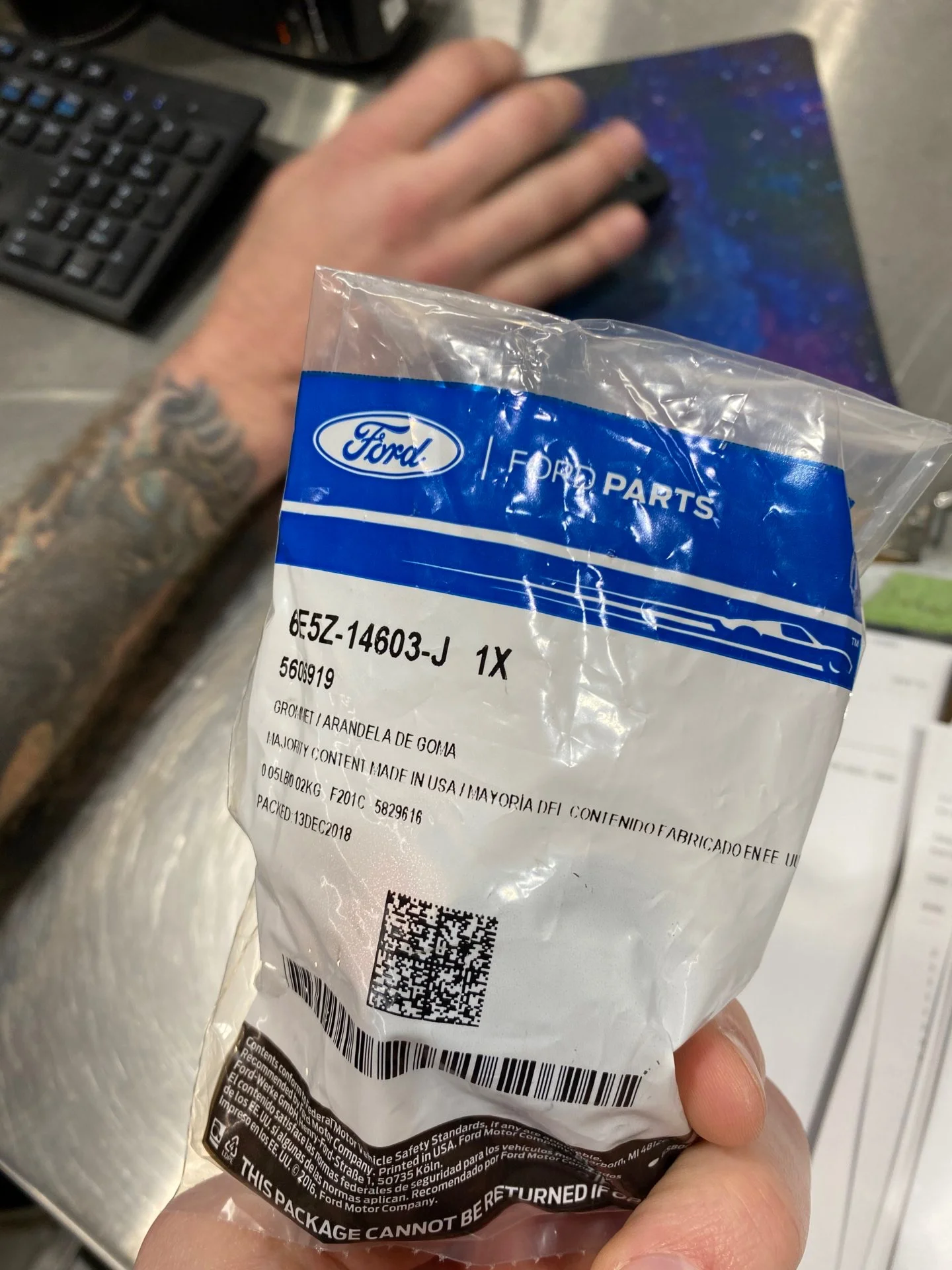

I don’t have any good suggestions, but I’d rather run wires through a good grommet on an existing body hole than drill. Eric Sarjeant posted a part number for the grommet his team uses awhile ago.

Don't drill. Use the spare hatch grommet. Much cleaner and factory looking.
Ok I like that method thank! I just shared the link with my install guy so fingers crossed he hasn’t already drilled the roof. I gave him the go ahead to drill last week but hopefully he hadn’t gotten to it yet. And yes his plan was to drill near where the sides of the roof rack attach, then drop the headliner so I wouldn’t see anything inside. He also is adding an Anderson connector under the solar panel if I do want to change anything in the future
