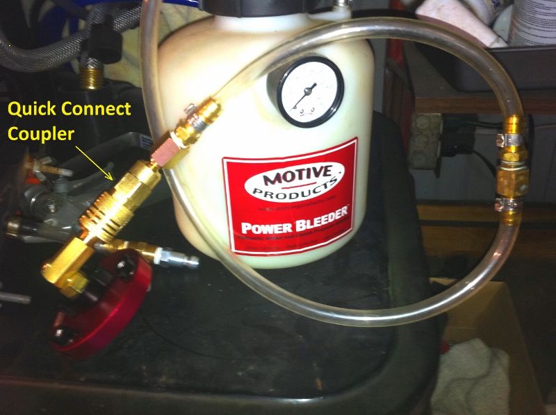

The best way to bleed this system and not deleting stuff is a pressure bleeder I have done dozens and never had problems when I use a pressure bleeder...............
I've used a 'Motive' pressure bleeder for the last 12 yrs. or so. I consider it the easiest way to get a continual flow of fluid, but it has not been my experience that it changes anything related to getting all the air out of the Anti-Lock system or the LSPV. It makes a fluid exchange much faster than other techniques and doesn't require a helper, but is nothing magical otherwise.
Ditto on the power bleeder for only being good for a fluid change. I have to pump mine to 25psi+ to get any reasonable flow. I traced a piece of 1/2" wood to match the plastic cap so it cannot flex and burst off the fluid reservoir when tightening the chain. Flintknapper's cap is pretty sweet though.
