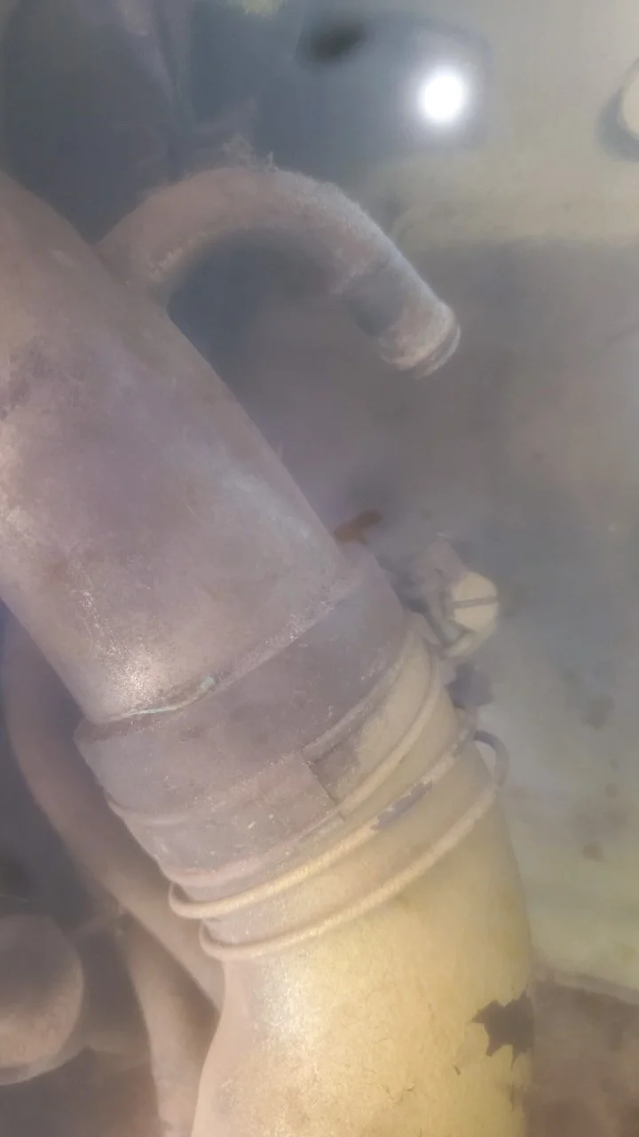

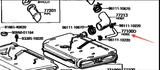

Anybody have any clue as the ID of the hose that runs from top of tank to ancillary connection on the fuel filler neck? Connects to the top of the tank. I assume it's a way to balance pressure or recirculate fumes. Can't find anything by looking up the part number in the diagram below
Attaches here and has black cloth mesh around it.
Pretty big ID as well. Putting together my McMasters order figured I might as well order 'em all, even though my current one is in decent shape for 46 years old (better than me, that's for sure)
Of course, I can always measure mine, but I was hoping somebody had an official measurement.
Eureka! Posting for maybe somebody else.
New part number is 90445-22024 Still available from the dealership.
