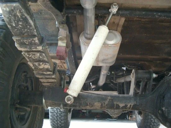

How about something like this:
attachment.php
I set up my FJ60 the same way and it works really well.
Yup that's what I'm thinking, might even go more vertical than that. Really anything I do is a band aid for the fact that the springs are to soft and it's just something that you live with when doing a SOA:frown: It just drove me nuts when I drove this cruiser for the first time yesterday. Between the handling and the lack of good brakes it wasn't a fun drive at all.:steer:
