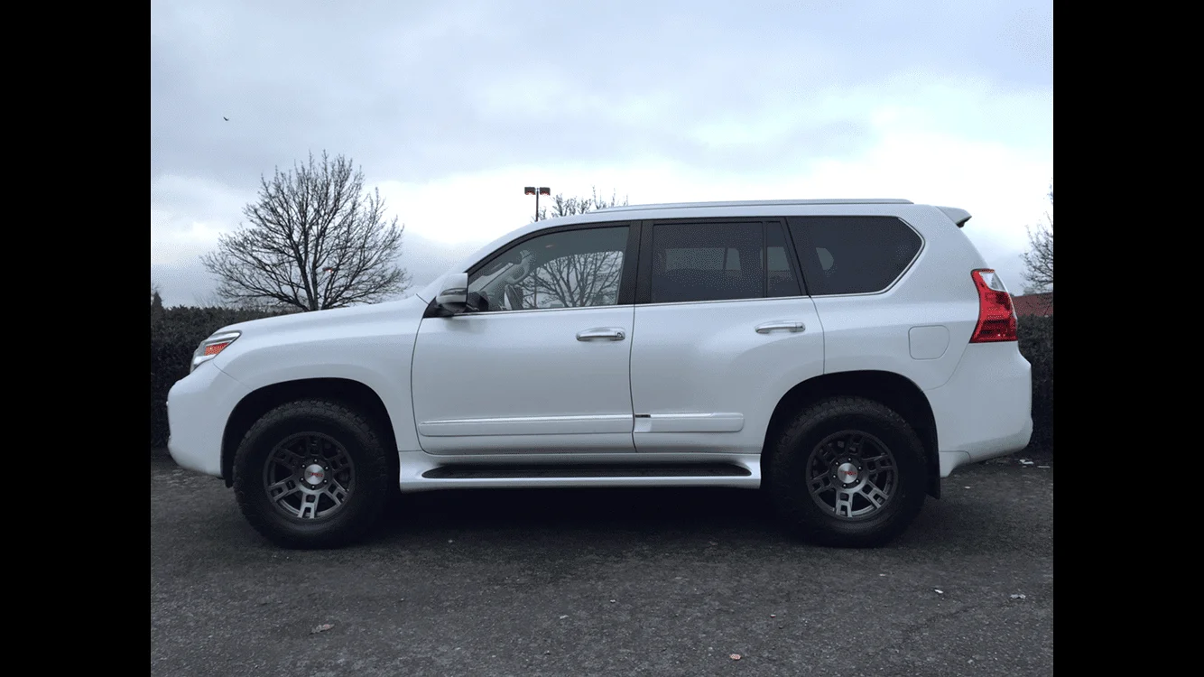

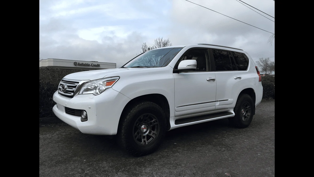

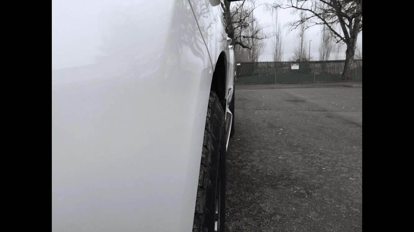

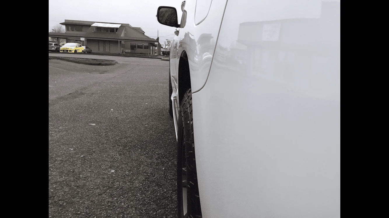

These are 17x8 +0
Tire size 265/70/17

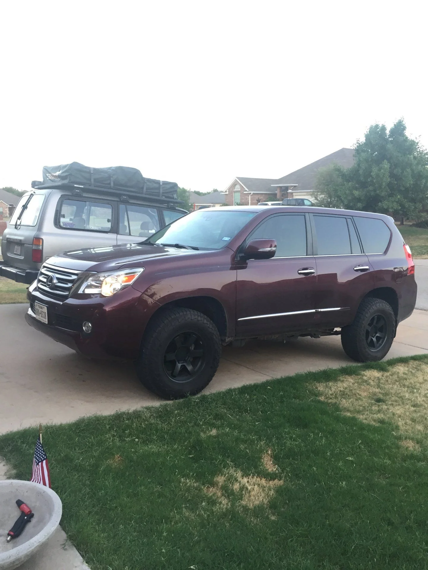

View attachment 1454355 I run Evo Corse with 0 offest. 2" of lift on BP51 and 34/10.5/17 KO2. HAd to push the front plastic in a little .
