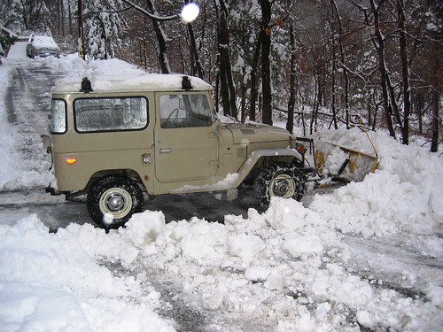

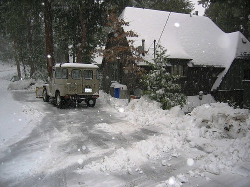

The new brackets are all fabbed and mounted and I have just finished plowing our first "real" snow of the season.....about 15 inches or so. The set-up worked perfectly. Here are a couple pics:
The guy helping me finished the bracketry on Sunday afternoon and it started snowing Sunday night, so I didn't have time to get it painted and "all purdy" but I will later (probably Spring, realistically).

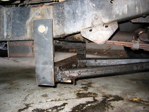

Here are a few shots of the components.....
This is the front hoop as mounted across the front frame rails:
This is how we eliminated lateral movement....a piece of 6 inch channel instead of the two pieces of strap steel that were there previously:
Here's one of the rear, frame-mount brackets....you can also see some of the traigulated "channel" that was made from 2" and 1.5" heavy wall square tubing.....believe me, this is stout:

Very similar to my set up..one thing I noticed on mine is that the bolt through the frame at the rear is under tremendous amount of downward "shear".. I upgraded to a grade 8 for strength.
keep us posted.
Yes, Bennett, you're right.....I'd say those two bolts through the frame carry the majority of force. I'm running grade 8's also. I thought about going to structural bolts, but then realized that I'd rather shear a grade 8 than to have the frame warp.
Oh, BTW, we welded a piece of strap steel about 3 inches long on one side of each nut for the rear mounting bolts (to tighten the bolt without having to get a wrench inside the frame channel) and a length of 1/4 inch rod to the other side to fish it into the proper spot......worked like a charm. I'll post a pic when I pull it off to paint everything.
