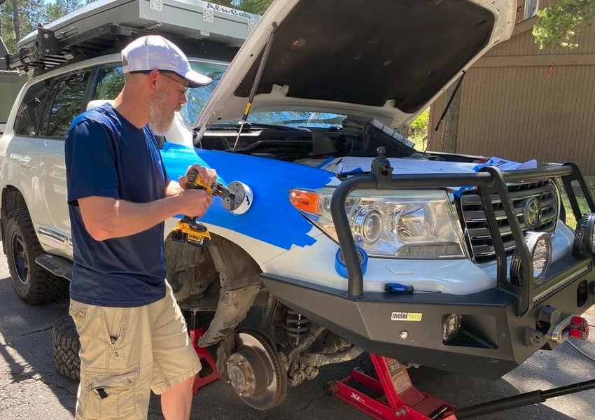

I did an Ironman a few years back.
Drilling / cutting is super easy. Just measure twice. And don't trust the template, verify each step by test fitting.

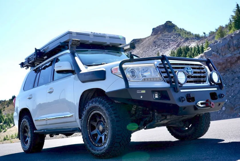

isnt there a oem one in Africa Gibralter Toyota with cyclone?
I put a Chinese tjm clone on. It was all fine. It’s been quite a few years now and the plastic is still solid. The petrol air box doesn’t use the same connector as the diesel air box. It came bolt on ready for the diesel.
In retrospect being able to fit a cyclonic cleaner like the ARB allows is a pretty good feature the tjm lacks. Particularly if you’re trying to maximize dust collection. If you can find the 200 OEM snorkel, I think it came with a pre cleaner.
Thanks! I love that hard action shot with the hole saw, and thanks grinch for the veto of the TJM look alike.
