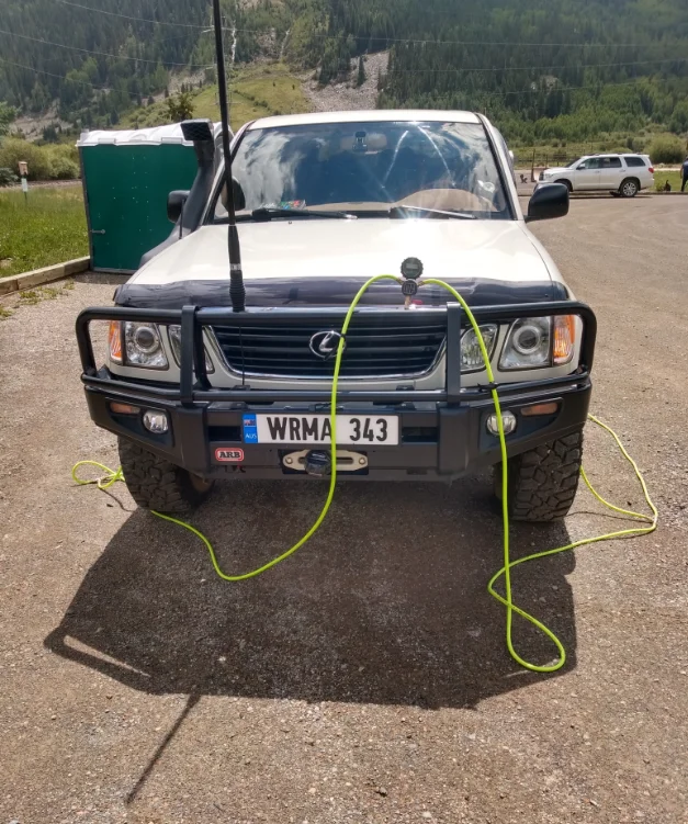

I have the 2781 that I run with the MORRflate 4 hose system for 4 tires at once. My son bought it for me 3 years ago. I've been using it 2x monthly for over a year. I do not use the hoses that came with it. I use it with a MORRflate adapter. for 4 tires at a time I can usually air up my tires and one or two friends at the end of a run. Though it is only 5.6 CFM. I would like to move up to a 10+ CFM unit. We have a guy in our club with a 10+ CFM until that blows everything else away.

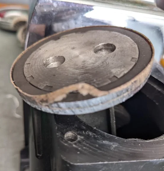

Although I got many good years out of my Smittybilt 2781, it did start to get obnoxiously loud. I replaced it with a 3/4 HP Puma. I took the Smittybilt apart and learned what was causing the issue - the piston ring failed. I will say it continued to work even with the failed ring and badly scratched cylinder bore.
