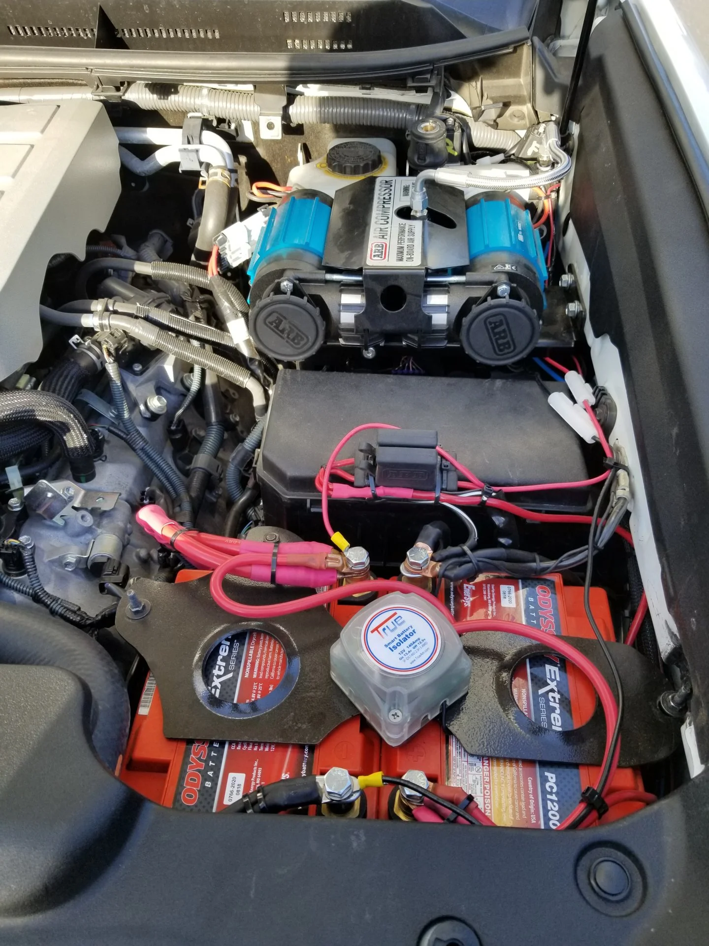

FYI, the stock 24F or larger 27F can be hard to find in an AGM. I tried for my rig and no one had one in stock. I ended up with an Odyssey 34R, which has been an awesome battery. It fits in the stock location with a 1" wood spacer under it. That being said, if someone would have had a 27F in stock when I needed a battery on short notice, I would have bought one. Summit Racing is where I normally get them at, but you can also order them through Autozone with free shipping. Once you have a good AGM battery, it's hard to go back to a normal flooded lead acid.

I've been using Odyssey batteries for decades. Smaller than lead acid, but heavy. I have PC1200's in the stock location, one for house, other to starter.
