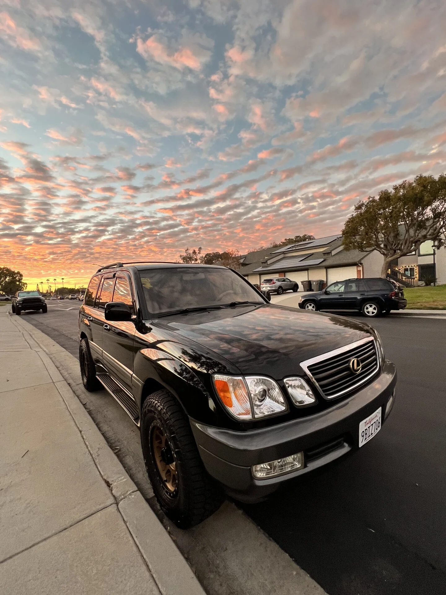

Hey guys! I just purchased a 1999 LX470 (woo!) and obviously there are a few little quirks. We're getting some heavy rain in SoCal right now and I noticed a slight drip in the rear middle section of my sunroof, my drains are all clear and just curious what else it may be before I take it in? Thanks! Added a photo of the ole girl.

Also, love the truck!
