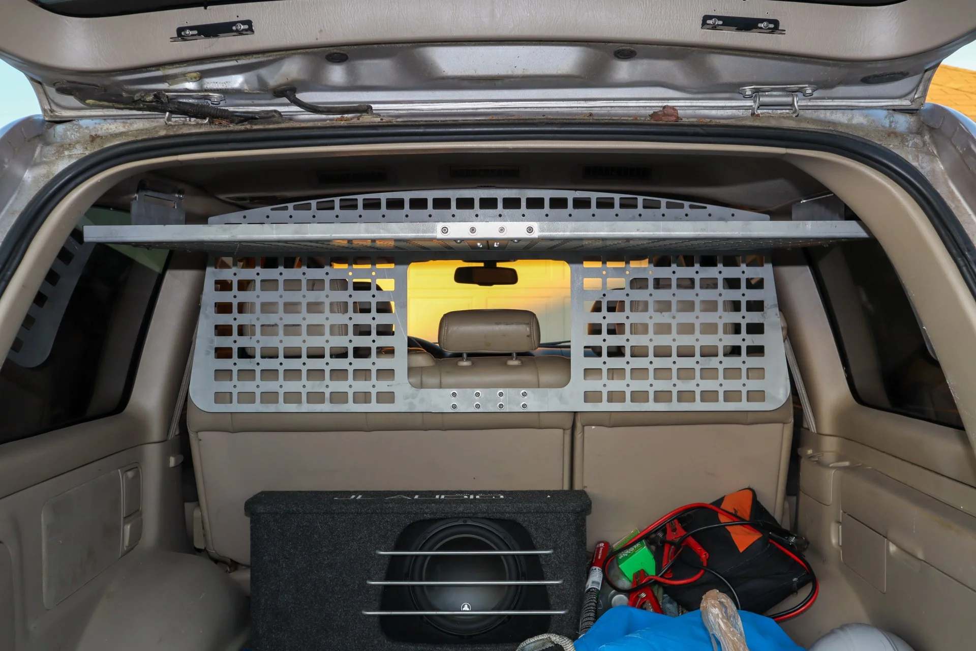

The boys at Victory 4x4 came through with the attic rack! So stoked to fill this thing up! Now I can get some of my excess gear off the floor. Almost all of it fits in my LL Bean rear seat organizer, but obviously I have too much lol.View attachment 2827394

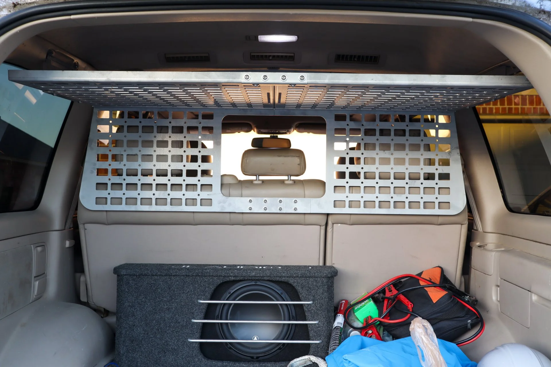

I'm trying to put one together that will tuck up as close to the headliner as possible while still maintaining enough distance to make it a useful storage area. I didn't want it hanging down level with the 2nd row headrests. I also made it deep enough to reach back to the D-pillars if it's adjusted to it's most rearward position. I sent mine off to powdercoat but should be getting it back and installed pretty soon.
Does the shelf require use of the pet/cargo barrier? Or can you just run the shelf without the barrier? My ideal would be having the shelf always installed, but be able to easily remove the pet/cargo barrier for ski season when the kids need to be able to reach back to the cargo area to get at their boots, coats, gloves, etc.

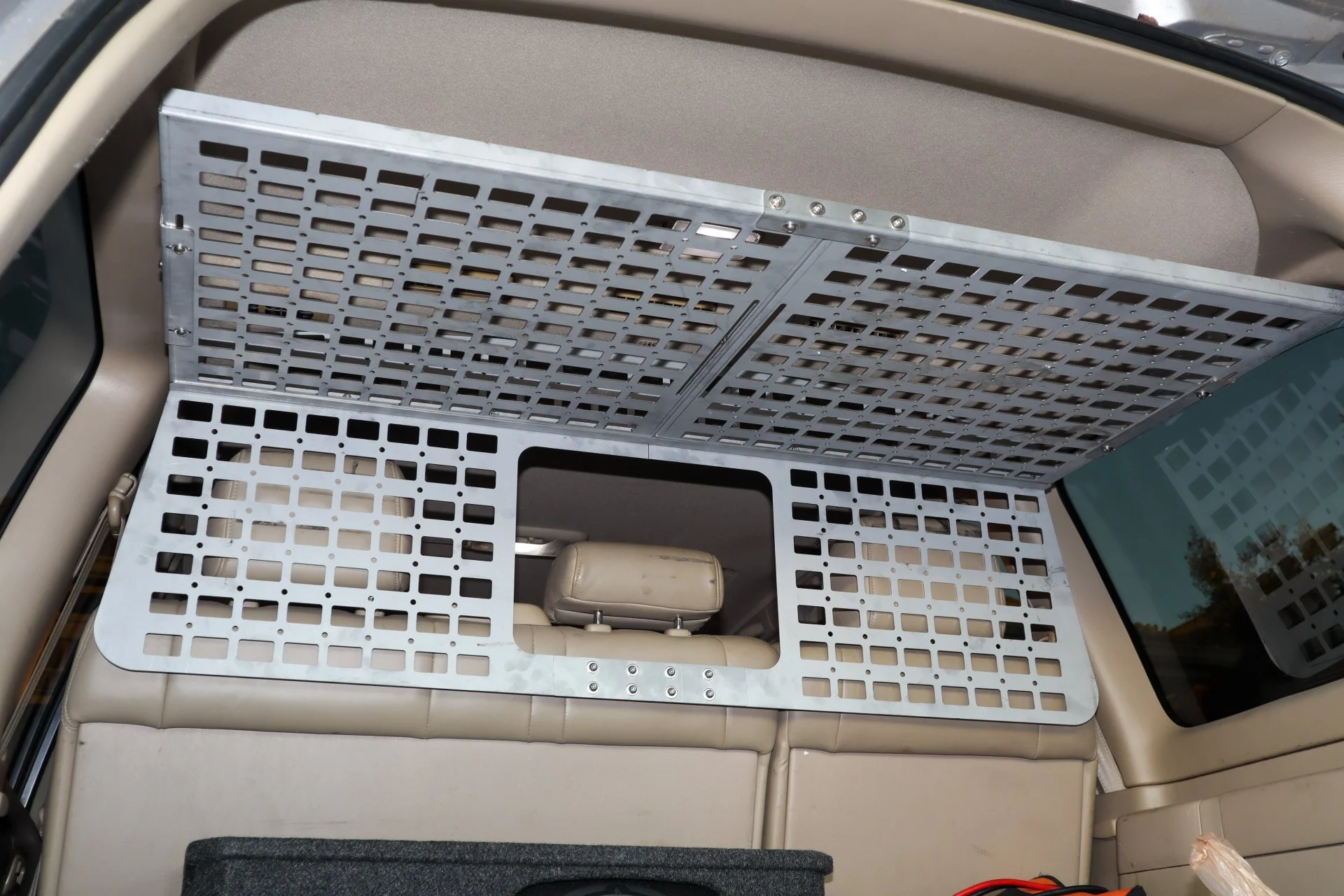

I'm making it as a modular system. The shelf can be run by itself with the upper barrier that contours to the headliner. The lower barrier that drops below the headrests will be an option, as will side panels to cover the quarter panel windows. The lower barrier will also have different cut designs for those who don't want the large opening in the middle. In the future I may do a vertical barrier perpendicular to the shelf to split the cargo area in half for those who run one 3rd row and a single drawer.

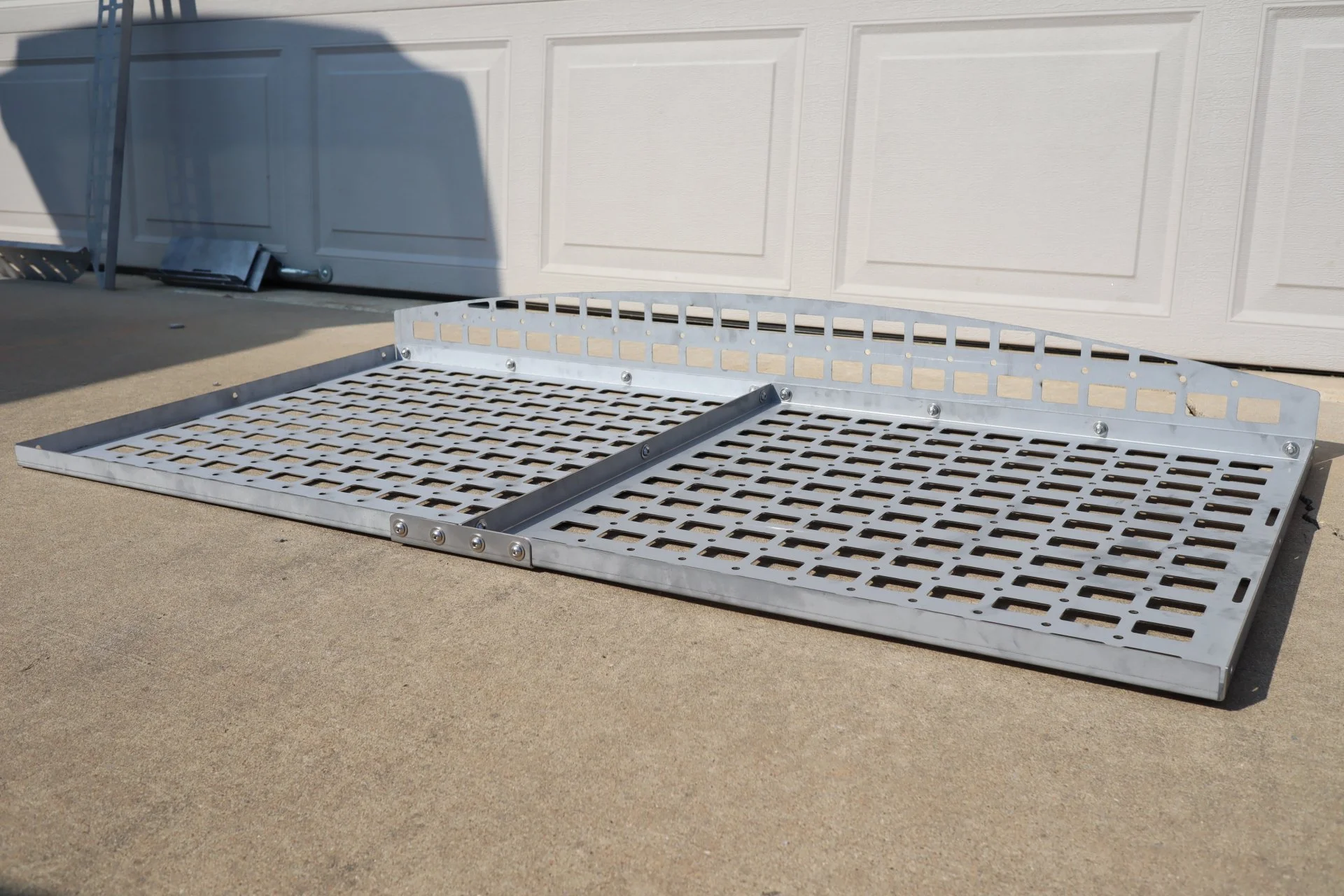

That looks well built @TheForger . Is that aluminum? And do you have the link where we can read more about your product? Thank you.
It is galvanneal steel. Similar to hot-dipped galvanized, galvanneal steel has a zinc coating applied to it but it's much thinner. It's then put in a furnace to hit an annealing temp. It is specifically designed to take paint/primer/powdercoat exceptionally well. It's also very easy (and much less dangerous to your health) to weld than galvanized steel.
I haven't made any thread yet but I will soon. I'm waiting until I have the designs finalized, especially making sure to account for the powdercoat thickness and incorporating all the adjustability that I want. I have previously posted a couple times here including what it looks like without the lower 'pet' barrier

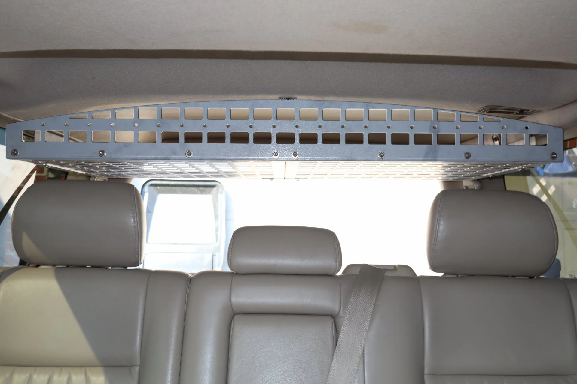

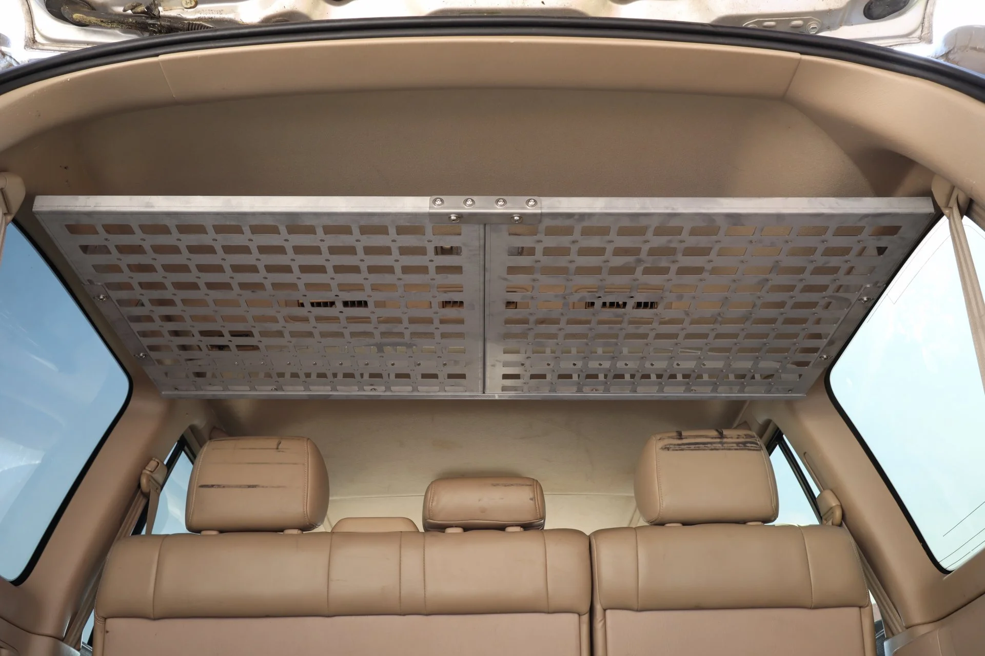

Been working on a new interior attic rack design for a while and finally got the second prototype installed. Still have some tweaks to make and several other accessory components (vertical barriers and quarter panel grids) to finalize but it’s getting close!
Yes! Laser cut on an Amada Ensis 3015AJ fiber laser and bent using an Amada HD2204NT press brake using USA steel
Yes I have been seeing that and it’s an awesome solution! I’m trying to do something a little different by designing this as a “modular storage solution”. So not only will there be this shelf up top, but there will also be a vertical barrier that will drop down and hug the back of the second row, as well as side panels to cover the quarter panel windows. Almost an a la carte system. On top of that I’m making wall-mount brackets for home/garage applications
Thanks for the info. That sounds great. What do you think your timing is to make start marketing this?
Will try to get them together before Christmas. I really want some 'in stock' before I do a group buy
