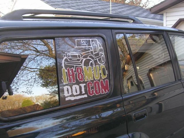

Just curious.. what are you doing that you need or want to take out the slider windows?
figgered doing this on the kitchen counter would be easier.....but, once the latch was removed, it wasn't that tuff with the window on the truck
That is a sweet decal, any plans to make it public?
Or, as Ron White would say.... pubLIC?
Uz byatch why don't I have one of those to pimp my 80? :crybaby:
damn things are $30 ea...uugh...it's actually a "full window" sticker, done with very small holes so from the outside it looks great, and from the inside you can barely see it....
I pulled the latch, left the window 1/2 slid open, and with one of their funky "squeegies" and a lot of patience, got lucky and got 'em centered/installed right the first time.
The sticker shop was pretty sure i'd screw it up, and are planning to make me another on monday to fix my first attempt....lol....but my mad stickah skills prevailed....
Trim 'er out with a razor, and it's done....took about 20 mins each to do....
NO plans to make these a sale item, they really are too much of a PITA and expense to install, but I AM planning to do white outline stickers of some of the rig images....
