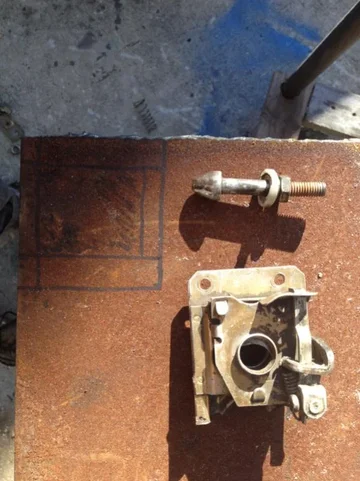

Alright gents, this is what I came up with:
A VW? hood latch and striker bolt from eBay. I have a reinforcement/mounting bracket ready to cut out.

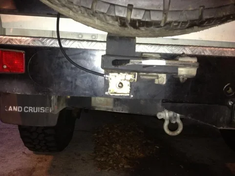

Here's the latch mounted inside the reinforcement plate, which I welded to the swingout. You also see the push pull cable attached.

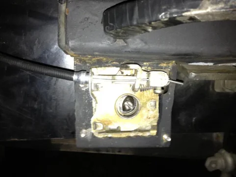

The close up of it. I got some Kydex on order that I'm going to use to make a cover and hide this. I will post a picture of that later.

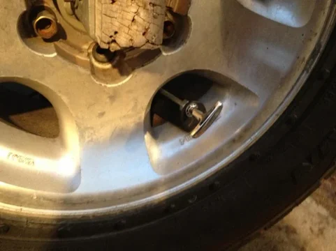

Here's the T handle to the push pull cable also from eBay. I fabbed a bracket that comes out through the spare tire.

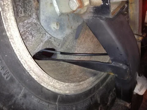

Here's the inside of the swingarm where I welded the bracket.

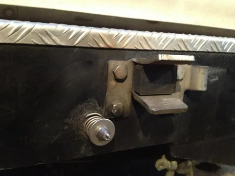

I drilled and tapped threads into the bumper for the Striker bolt.
I'm pretty happy with the way came out. I will post a video of it in action, it got dark so I figured I would wait for daylight.
It's a lot more convenient now for grocery getting.. Ugh, Wait no, I mean going to Home Depot.
Pat
