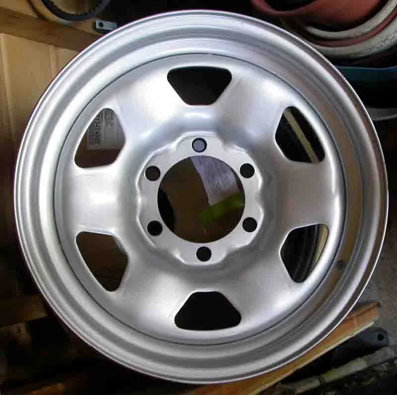

easy,
stock rims from a LJ78 (most, if not all, are 16")
factory steel 16 grey rims are skinnies ($80-$85 a peice brand new)

Great! How do they look like? Any Chrome versions by any chance? Where can they be purchased? Any correspondance to a north american manufacturer catalog number or north american Toyota such as the 4 runner or pickup?
Thanks for your input, it's much appreciated, Wayne :)
Chris
This is the one Wayne is talking about.
:cheers: :cheers: :cheers: :cheers:
YESSSSSSSSSSSSSSSSSSSSSSS! Right ON!!! Where do I get some?! Do they exist in Chrome ?
better yet, where can I have some made out of Stainless Steel ?:grinpimp: :grinpimp: :grinpimp: :grinpimp:
I dont think they come in chome - or stainless, get them from a toyota dealer. Do a search on toyota 16 inch steelies in the 70 series section - -the part number is in there. Dont bother calling toyota to find the number - they wont know how to find it.

Steel Rim 16 inch x 6 inch, Toyota OEM, Silver: 42601-60262-03
I believe I owe the part number to brownbear
Thanks, Darryl!
I'll be in touch with Toyota Lachute and Toyota Ste-Agathe tomorrow. You never know, I may be lucky...
