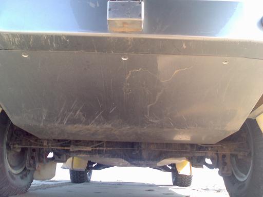

Jordi's armor:

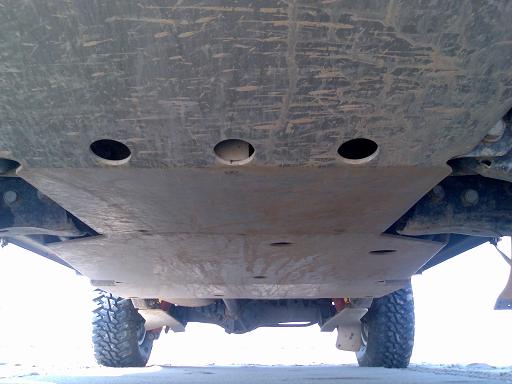

Jordi's armor:
Send me the cad files so I can make some PLEASE!
Some would have to be modified for me as the 100 turbo diesels have a different frame width I think. (I'll still take the drawings though!) Edit : Frame width may be the same, maybe I am thinking of the RFS and IFS widths.
Now that's a real skid plate! I'm sure it's even snowboarding-capable :)
Seriously, the frame is the same in the HDJ100 as in the UZJ100 (not in the xxJ105). What is different is the exhaust routing, since the HDJ is an in-line 6 cyl and it obviously doesn't have the twin cats. But I don't think this affects the armor design too much.

LEXUSBEN was testing the one Slee will be selling. Heres what slee had to say in the thread i liked to above.
The tentative pricing is $465 for the belly plate. We can supply an install kit for $75 that consists of rivet nuts, rivet nut tool (wrench type) and the correct drill bit (13.5mm)
The belly plate bolts to the existing cross member location and one other captive nut on the frame. Three holes need to be drilled and rivnuts need to be installed. We did not include the tool as we first thought we would since some people already have them.
The belly plate replaces the factory cross member.
The intermediate plate is $215 and the front plate is $375.
