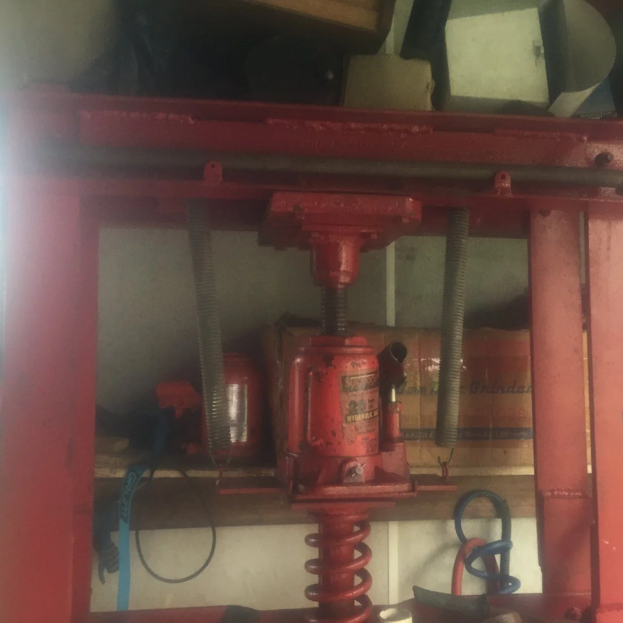

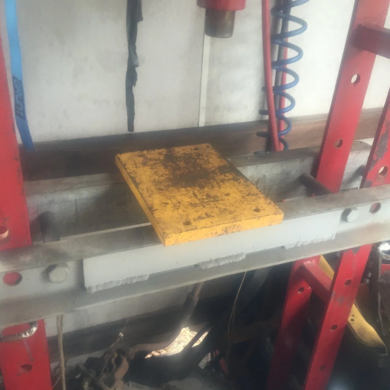

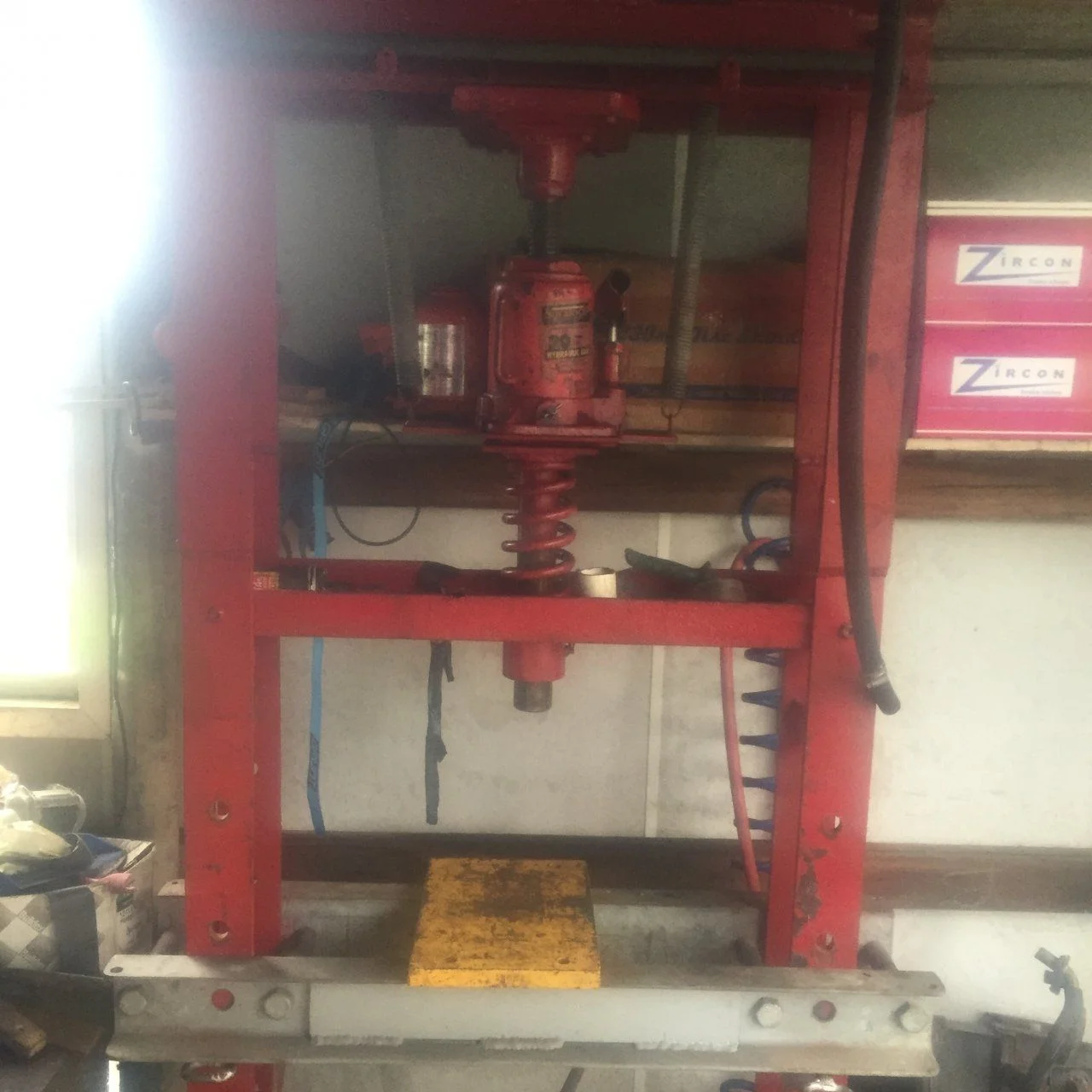

I built mine with a 20 ton bottle jack and it bent both upper and lower channels if you look close you can see where I put flat bar to both supports.
There's a s*** load off pressure at 20 ton you don't want anything coming out from that weight so over engineer.
