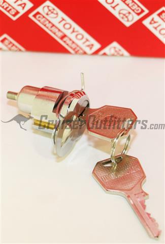

Doh, I was thinking when the handle changed. The key was single sided for the whole run of 4x rear doors i.e. the never used a double sided key for the rear hatch or ambulance doors.
This lock is the super common single sided style
-75 Side door and rear ambulance door variant, Cruiser Outfitters part# LOCK60010

right for ambulance doors , but .............o_O
will it fit side doors or the older hatch's lift type too ?

Side doors yes, lift gate hatch, no. That location was unique as instead of a square rear post, it was threaded for a linkage arm. Pics to follow.
