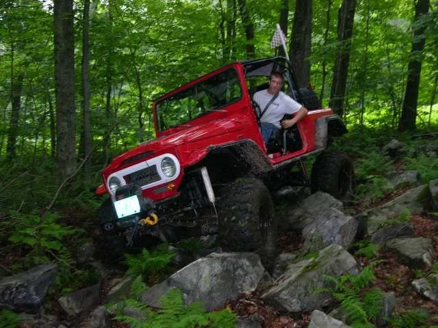

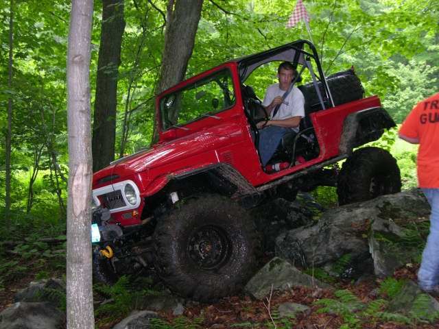

my problem is the shocks should be farther towards the outer end of the axle. They work great on the flat and loose effectivness on a sidehill. It rides like a cadillac over the roughest stuff and really suckd on a sidehill. I go around a corner on the road and it stays leaning some until I get to the next corner and it pops back. I just got my currie anti-rock in the mail yesterday. It is very scary off camber.

Adding to that, I saw that the rig in the first pics has just a simple strap in the middle of the axle, easy but would it work? Isn't a limitation for example when you need a high bump angle?
