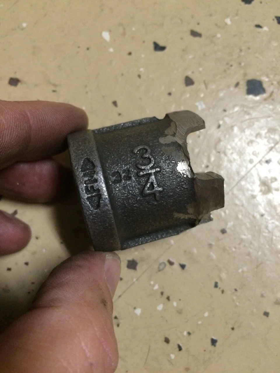

  • Application: compressing spring on outside (D/S, P/S) mirror posts to remove the U-shaped retaining sleeve
  • Raw stock and fabrication: started with a ¾" female-female threaded pipe fitting then ground to the correct shape with an angle grinder. It took a few iterations to get the clearances right
  • Works perfectly
  • Suggestions for the next guy: start with something (e.g. old socket) with a smaller outer diameter so you don't have to grind the outer perimeter down to make it fit

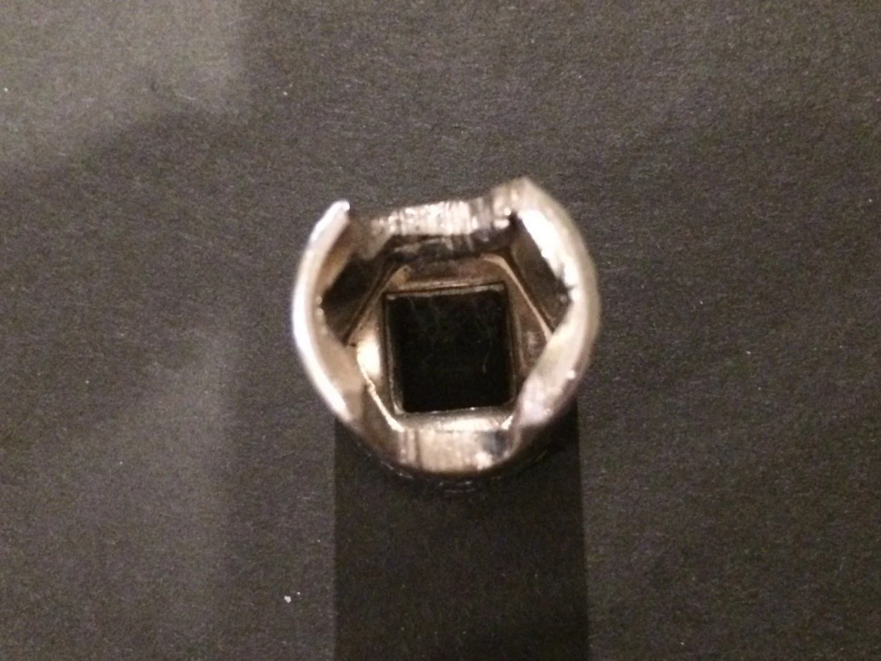

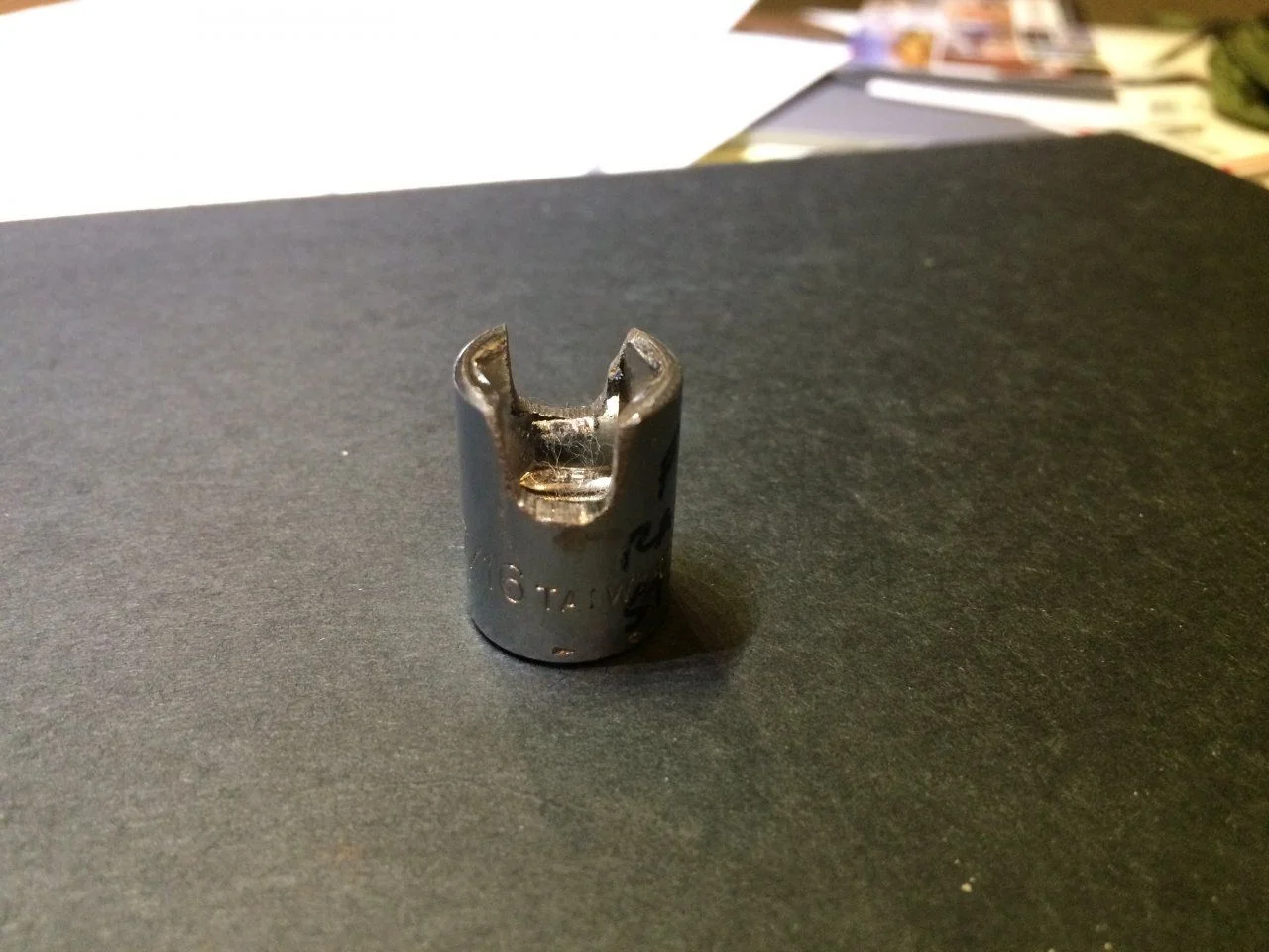

Second SST:
  • Application: removing the radiator stockcock -- help to get a grip with or without a ¼" socket wrench
  • Raw stock and fabrication: started with a1/4" drive 7/16" junk socket and used a dremel tool to grind out a groove that fits the stopcock handle
  • Works perfectly - it allows you to get a little more grip on the stopcock when reaching down from above
  • Suggestions for the next guy: works OK like this. pretty simple

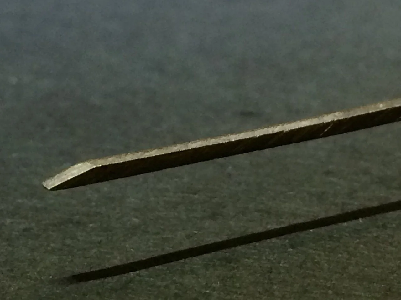

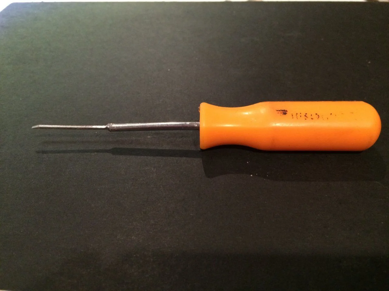

Third SST:
  • Application: electrical connector terminal pin removal
  • Raw stock and fabrication: el-cheapo HF awl; ground and filed until it met the FSM dimensions
  • Works OK but is too flimsy. It feels like it will bend or break if bent
  • Suggestions for the next guy: start with higher quality steel; not HF pot metal junk

Buy a cheap file to make the wiring SST - need high carbon steel instead of whatever that stuff HF makes it's cheap tools from . I'd use the tang end of the file , if it's too soft heat it to a low orange and quench in old motor oil (keep an extinguisher handy, please) .

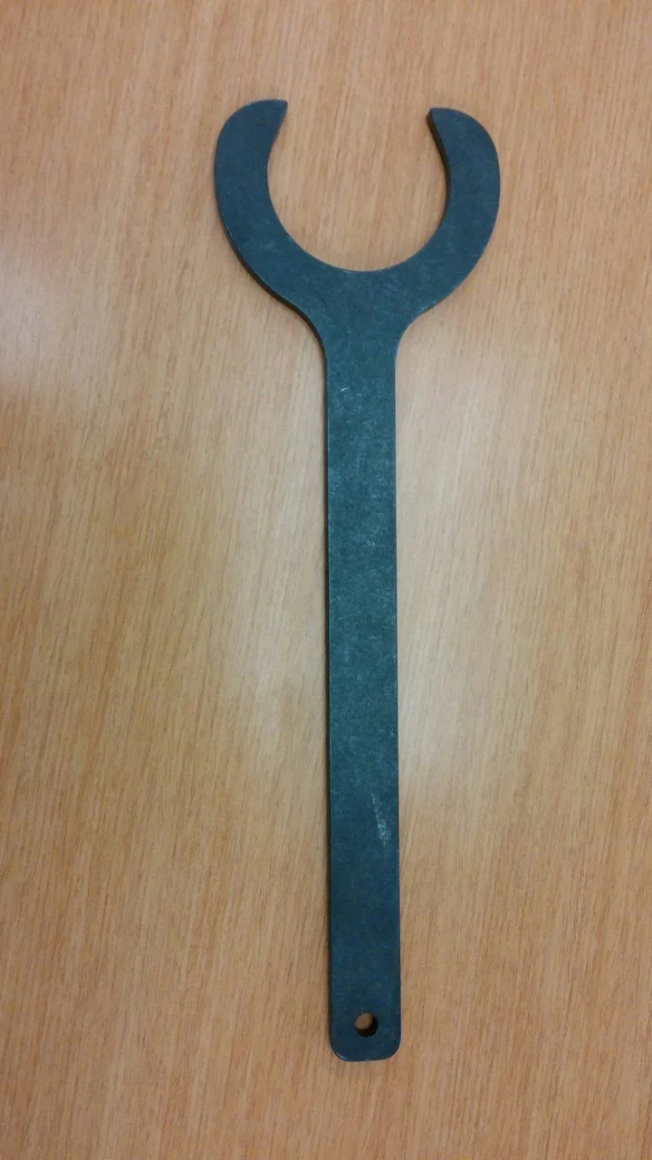

STT wrench for accessing the hard to reach supercharger pulley to R&R the SC belt.

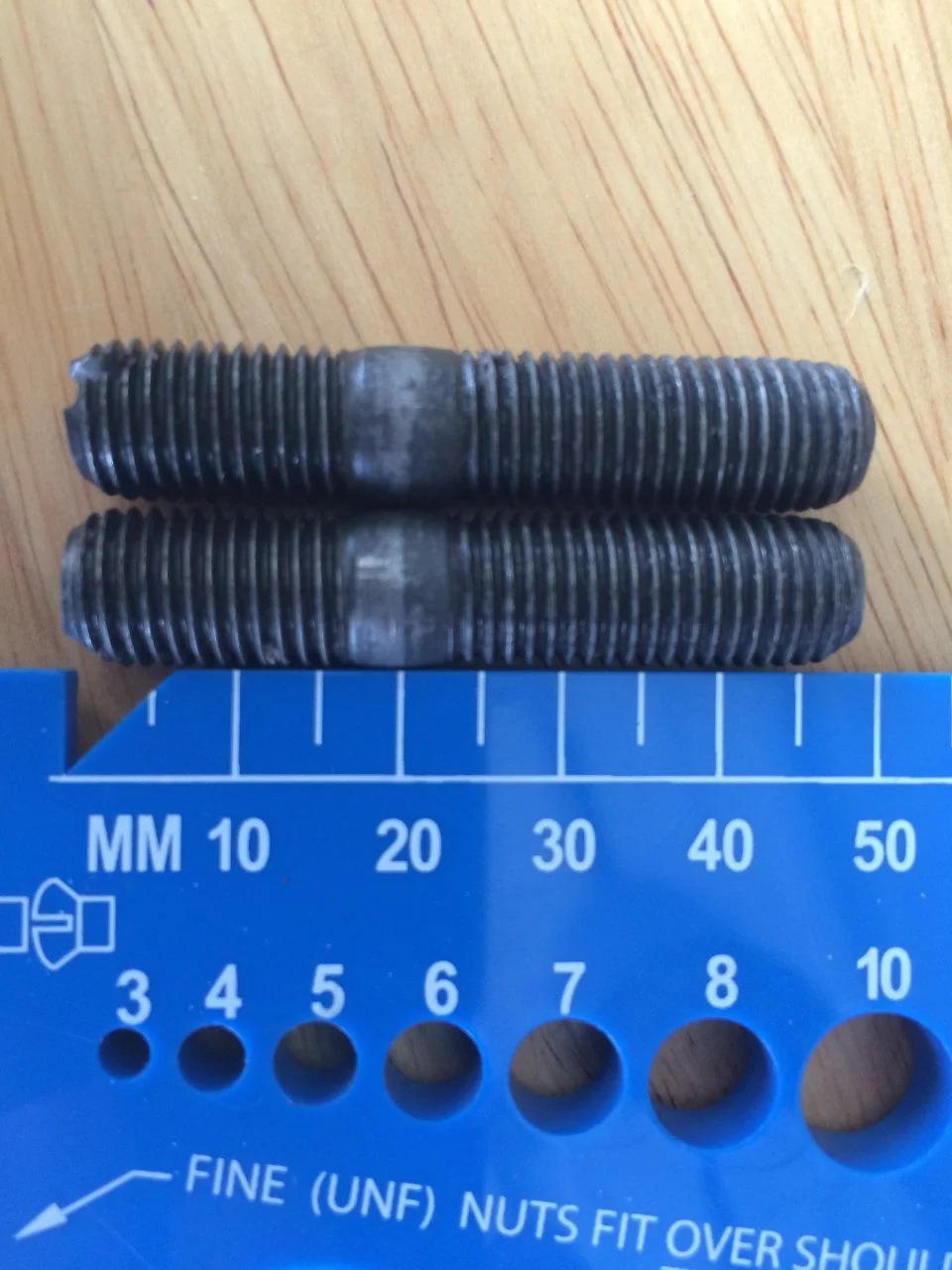

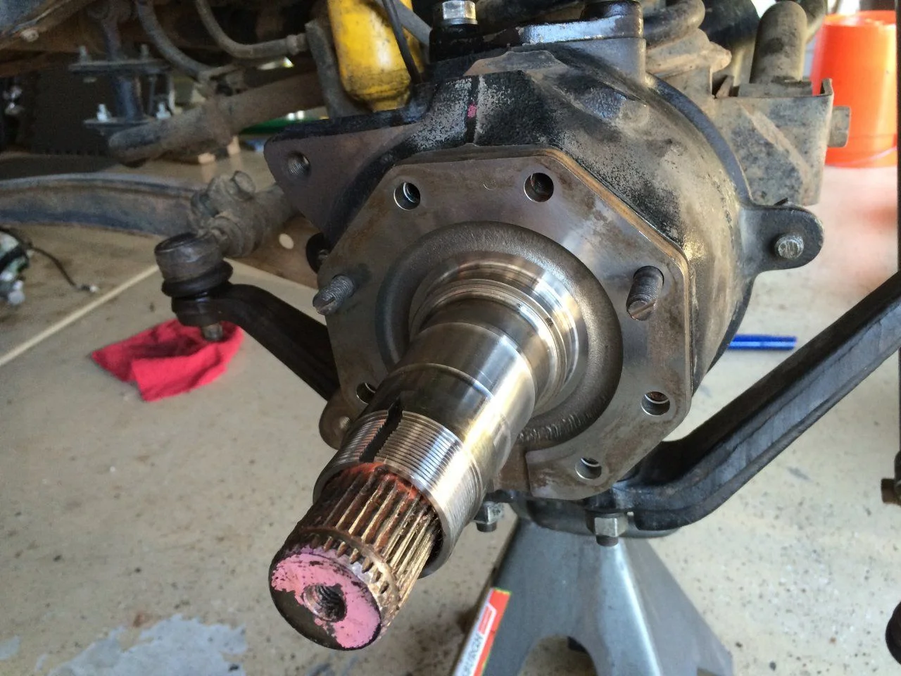

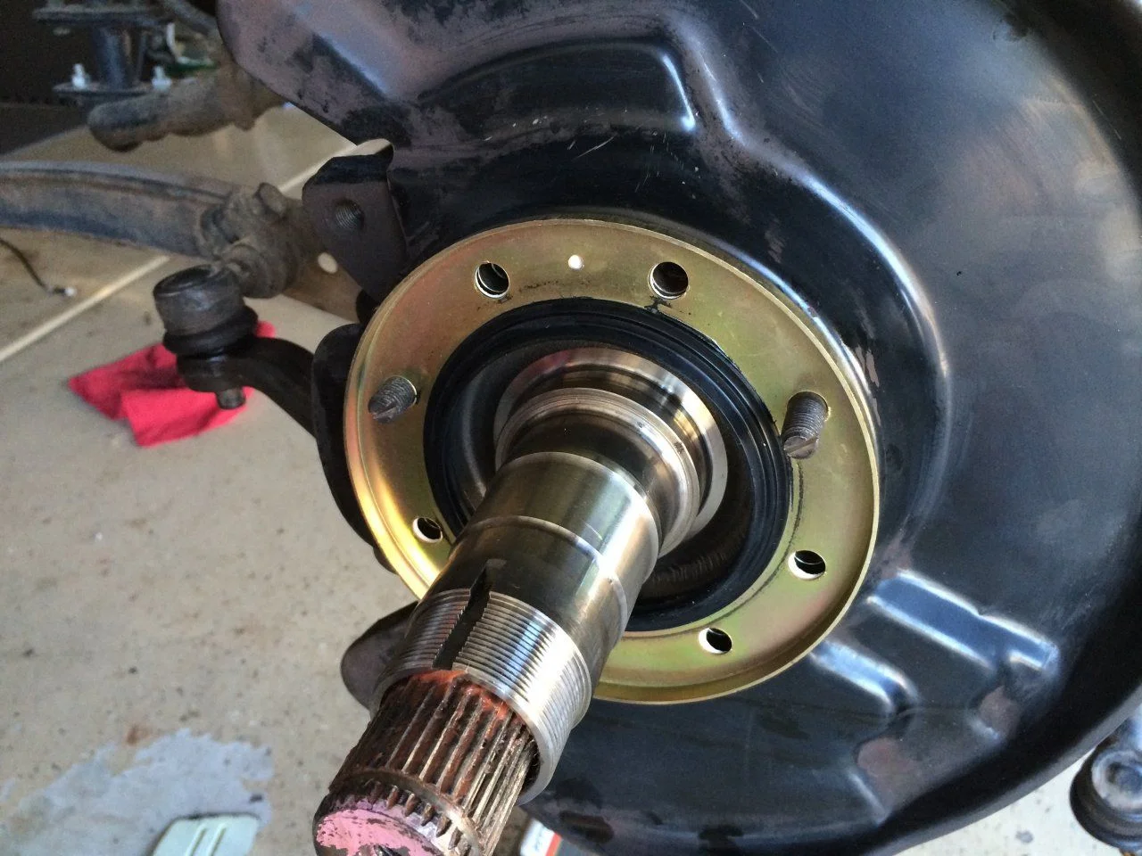

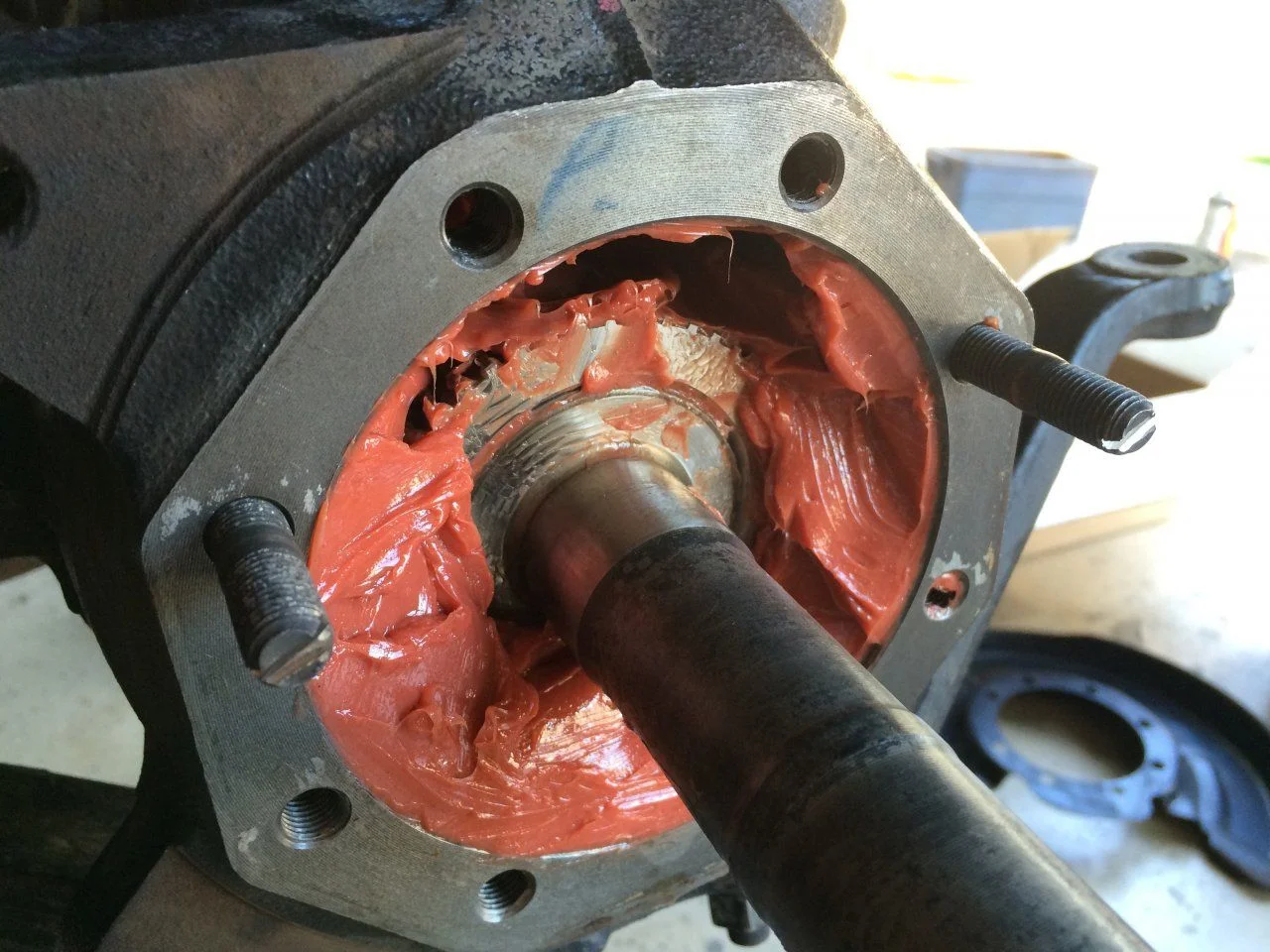

  • Application: holding the spindle, gaskets, dust shield, etc. when reassembling an 80 series knuckle
  • Raw stock and fabrication: 10mm studs; then grind screwdriver slots in
  • Works great. Many mud members recommend. Super simple, yet saves lots of hassle trying to position everything correctly
  • Suggestions for the next guy: simple and easy already
