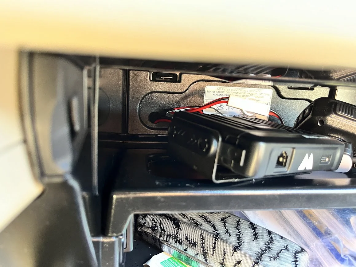

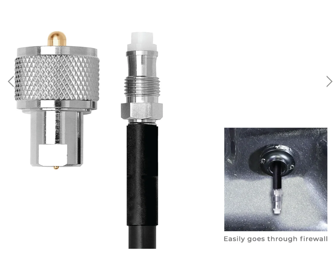

Did a quick install for MXT275 with MXTA26 6dB antenna and MXTA24 low profile antenna cable (Note, this cable's FME/UHF connector can be separated to go through firewall easily)

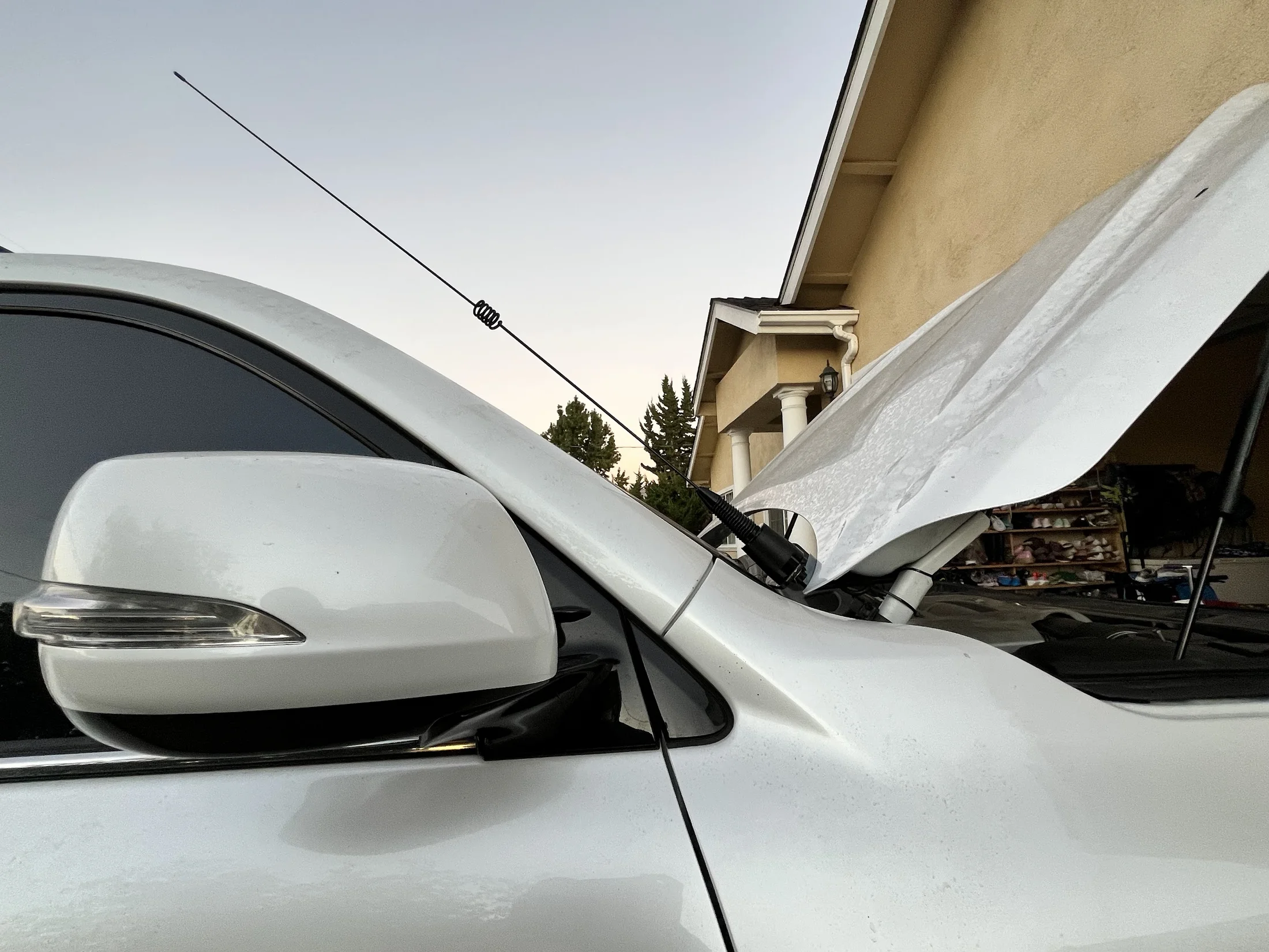

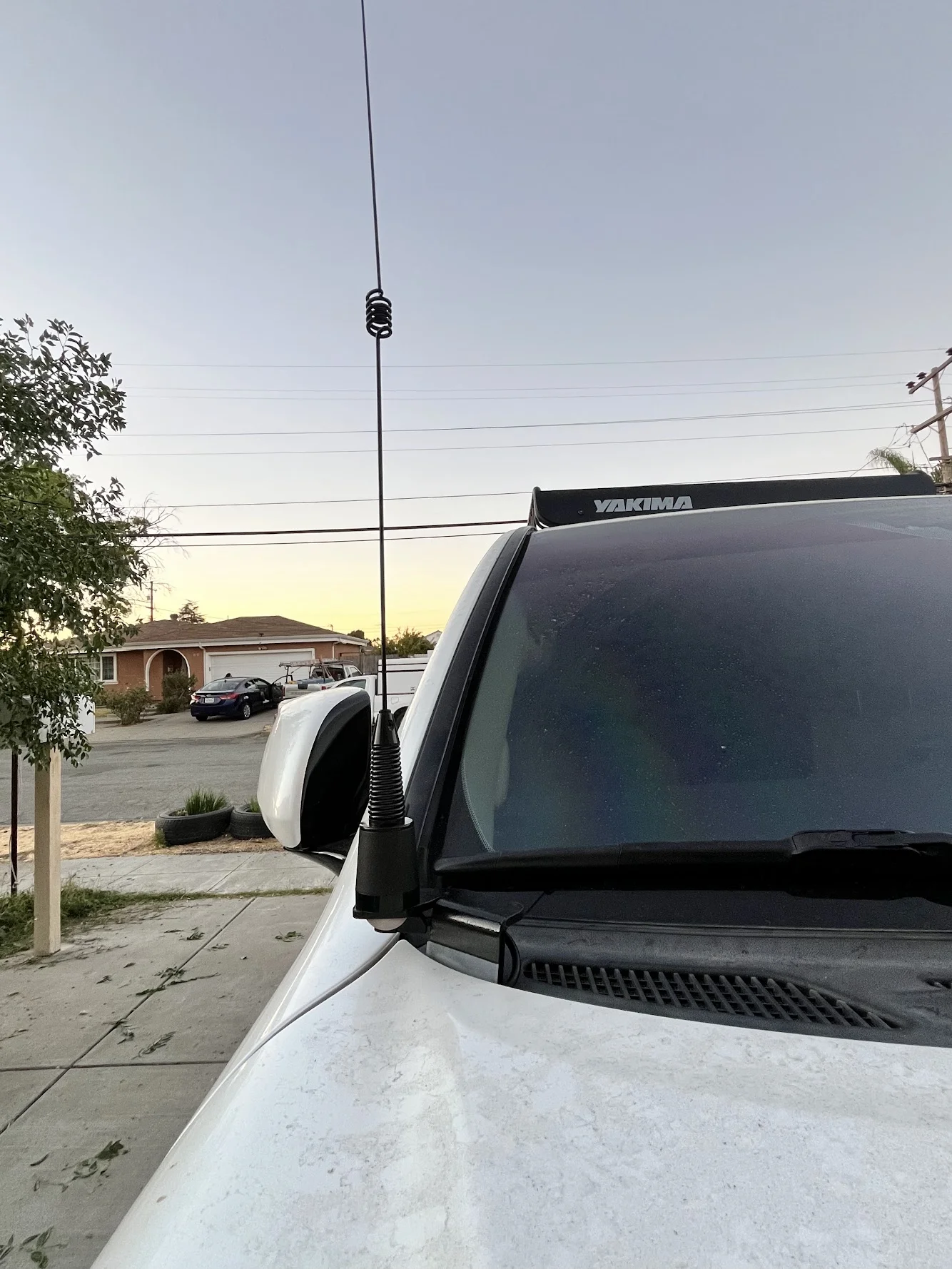

The SDHQ ditch light mount is perfect for the job. Very nice fit and just enough space. // Absolutely no affiliation with SDHQ whatsoever. :)

2) Mount the antenna using SDHQ ditch light bracket. Note the NMO connector requires a 5/8' hole; you need to enlarge the mounting hole on the bracket.
3) followed this video from Gamiviti to fish the wires through firewall. I don't have the silicon spray shown in the video, just rubbed a bit of butter, works perfect.
4) Did glovebox install. Remove the glovebox divider, open the cabin air filter door, fish the wires. I drilled on the cabin filter door, but you could drill on the glovebox too

A key difference is SDHQ moves with the hood and the Kaon remains stationary. Neither seems to get in the way of anything unless you run a snorkel.
Did u have to modify the bracket?
Yeah, you have to make the hole larger to 5/8" for mounting the NMO connector. Or you can DIY a add-a-mount (Note: the linked product most certainly does not have the right size hole as well, just for an illustration)
